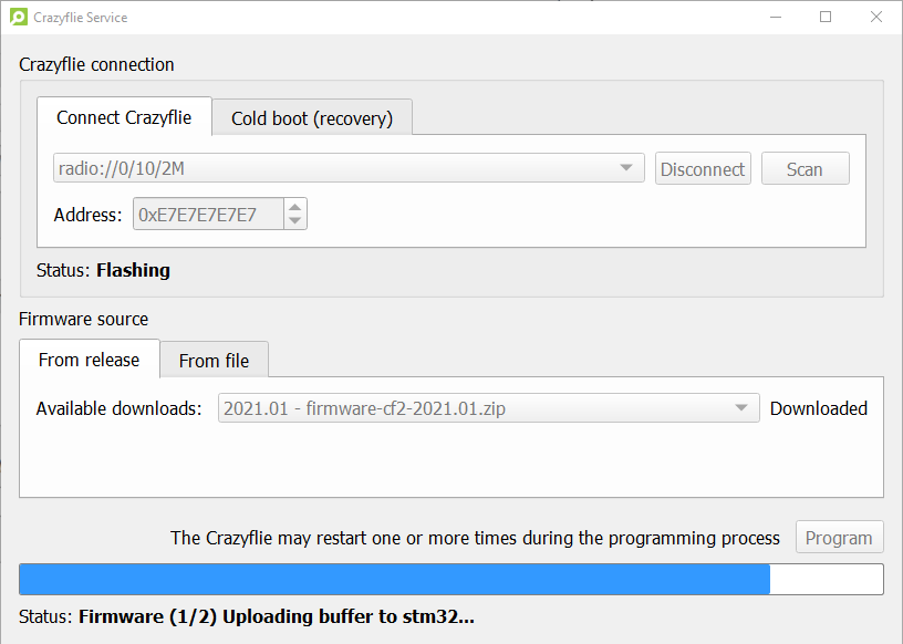

Firmware upgrade
For updating the Crazyflie firmware you can keep being connected to the crazyflie. This will open up a separate dialog that will guide you through the process.
Please note that you need to use a Crazyradio dongle to connect to the Crazyflie when doing firmware upgrades. Upgrading using USB is not possible.
Deck firmware
Some decks have a CPUs or other chips that runs firmware that needs to be updated from time to time as well. The Crazyflie firmware verifies that it is compatible with the deck firmware during start up. If the firmware in a deck that is installed needs to be upgraded this will be logged in the console log. Deck firmware is upgraded as a part of the Crazyflie firmware upgrade process, just make sure the deck is mounted when you run the upgrade.
To update the firmware in the Crazyflie 2.X do the following:
- Make sure to have any decks you will be using attached during the update, since some of the decks contain their own firmware which will also be updated during the firmware update. Also make sure there is a battery attached.
- Go to the menu Connect->Bootloader
- Connect to the crazyflie in this dialog, if it is not already connected in the flighttab.
- Select the latest release from the drop down menu or select it if you have downloaded it from the Github release page. Make sure to select the right platform (cf2 is the Crazyflie 2.X)
- Click "Program" and wait for both the STM and NRF to be flashed.
- Your crazyflie will automatically restart a couple of times.
- Do not touch or restart your crazyflie untill all flashing is done and you see "status: idle" at the bottom.
- To check the firmware version, under the View menu, open up Tabs->Console tab and look at the output when connecting to the Crazyflie 2.X.
If you accidently restarted your crazyflie during flashing or anything else happend which caused your crazyflie to not start up properly, follow the instructions for recovery mode.

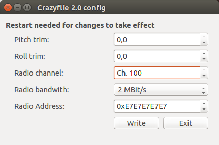

Firmware configuration
It is possible to set another channel to communicate with the Crazyflie 2.X. It can be wise to do this if there exist other wireless networks that can interfere, especially WiFi. It is also possible to permanently store the trim values for pitch and roll.
It is currently possible to change the following parameters which are stored in a none volatile memory:
- Pitch trim Can be programmed permanently with the trim values found to work good in the flight tab.
- Roll trim Can be programmed permanently with the trim values found to work good in the flight tab.
- Radio channel Can be set to anything between 0 and 125, correspond to a frequency from 2400MHz to 2525MHz. In most countries channel 0 to 80 is OK to use but this should be checked with you local regulations. If using 2M datarate, the copter channels should be 2 apart (2MHz).
- Radio bandwidth This can set the radio bandwidth to 250k, 1M or 2M. A lower bandwidth has longer range but has higher chance of collision. When used inside sometimes it is better to use 1M or 2M as it decreases the risk of collision with WiFi.
- Radio address (advanced) will set the shock burst address used for communicating. Note that if you change this then you will have to set the address correctly in the connect dialog.
The procedure is described below and the parameters can be changed again any time the same way.
First connect to the Crazyflie 2.X with the normal connect button. Then open “Connect->Configure 2.X” to reach the configure 2.X dialog
Once the settings has been made press the write button to save them permanently in the Crazyflie 2.X EEPROM. Then restart the Crazyflie and connect to the new address.

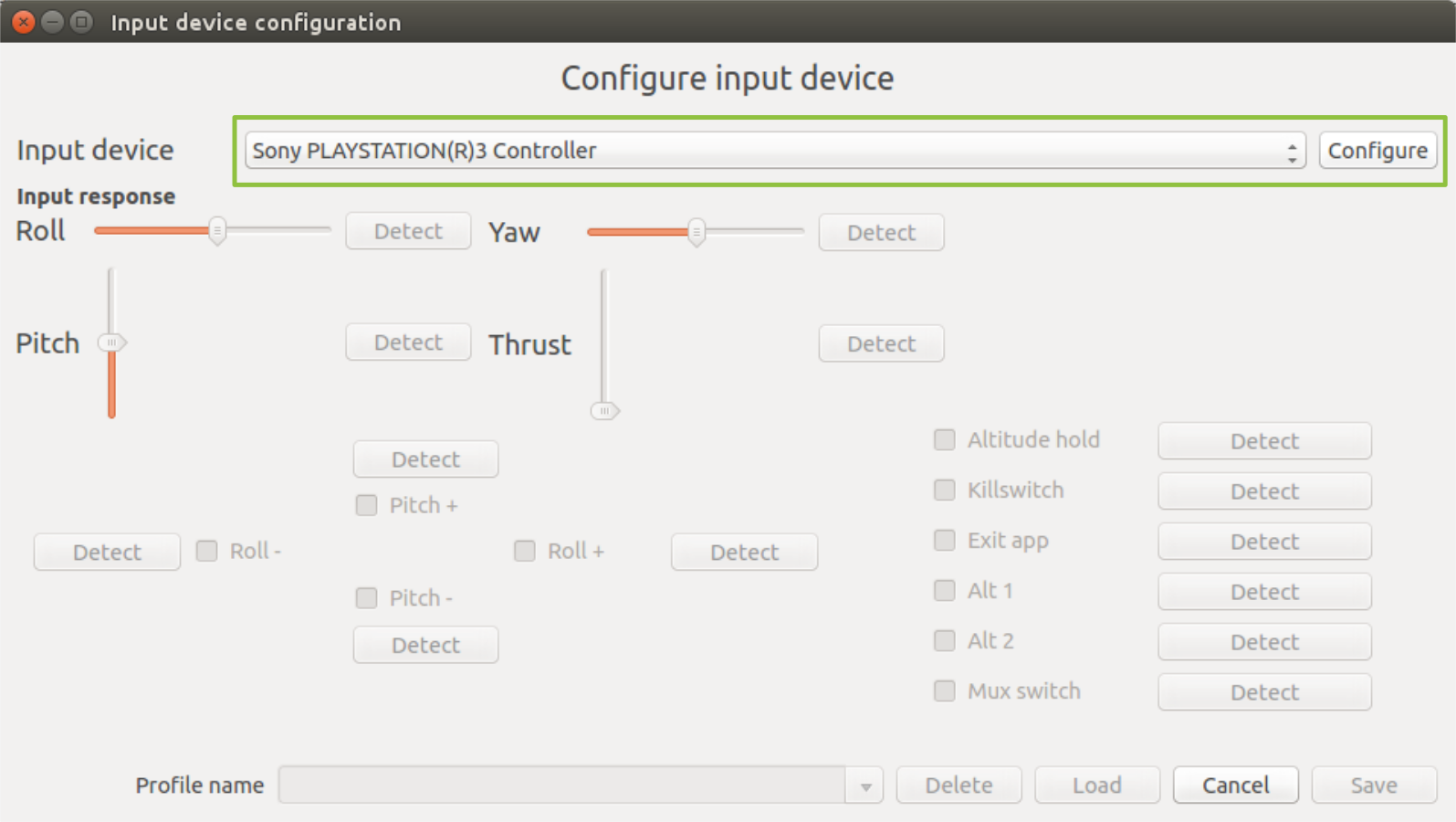

Creating new mappings
The software comes bundled with mappings for Xbox and PS3/4 controllers, but if you have another input-device then it's quick to create your own configuration. Go to the menu Input device -> Configure device mapping.
Select the device you would like to configure and press Configure.
For each functionality that can be mapped there's a Detect button, by pressing it the following dialog will appear.
Follow the instructions to detect the axis or button that you would like to map to the functionality. If you would like to map the functionality to two axis (like right/left shoulder-button) then select Combined axis detection and follow the instructions.
Go though all the functionality you would like to map by pressing the Detect button for each. To be able to save the mapping you will at least have to map roll, pitch, yaw and thrust.
Once you have mapped functionality you will be able to see the feedback directly in the configuration dialog (when you're not detecting a button). Make sure to check that the response is what you intended. When you are finished with the mapping then enter the map name and press save.
If you would like to start from a previous configuration and change it (either to update or to create a new one) then select the appropriate mapping in the drop-down and press Load. Once you have made the changes you would like to do then either press Save without changing the name to update the mapping or enter a new name and press Save to create a new one.

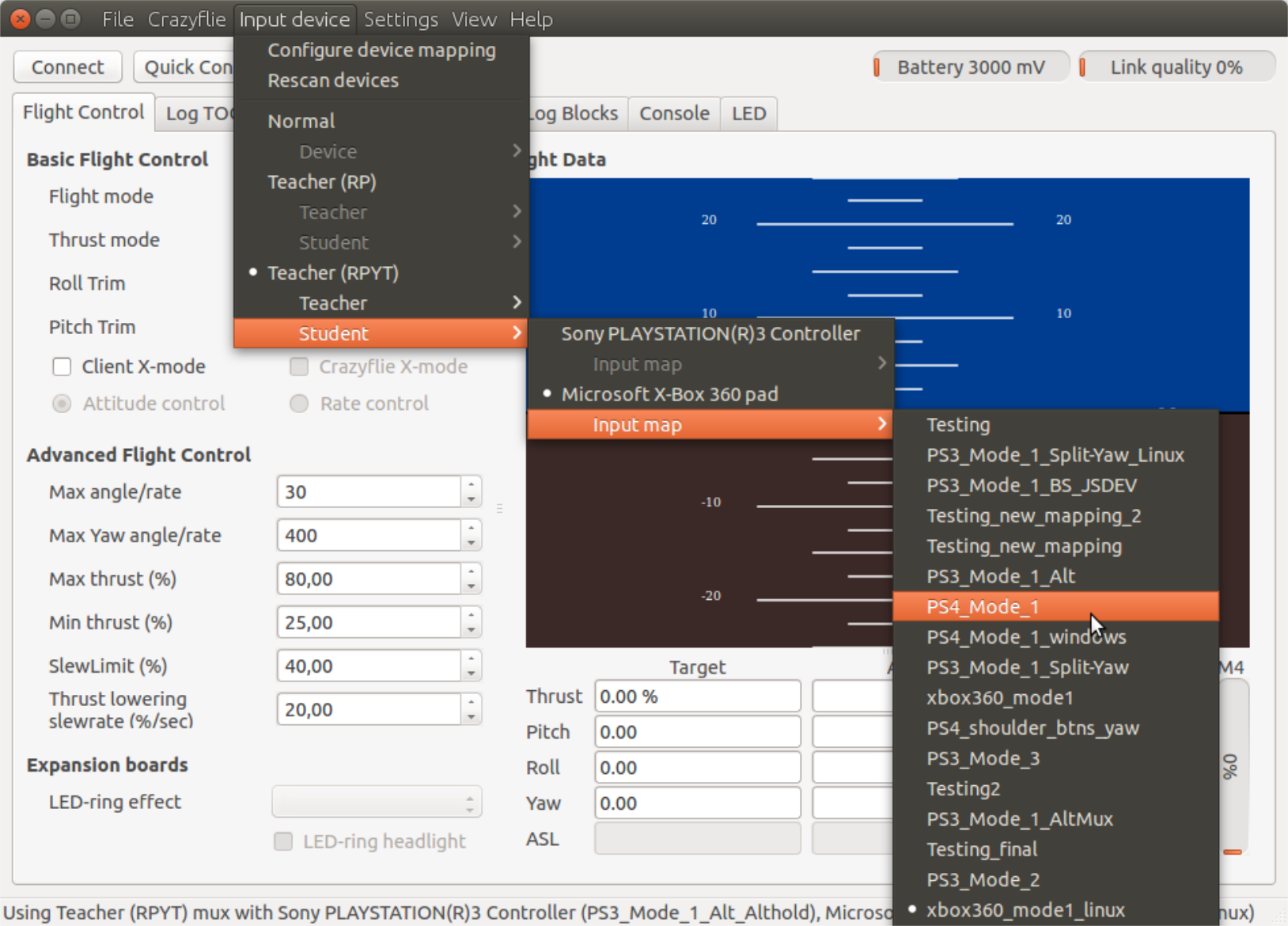

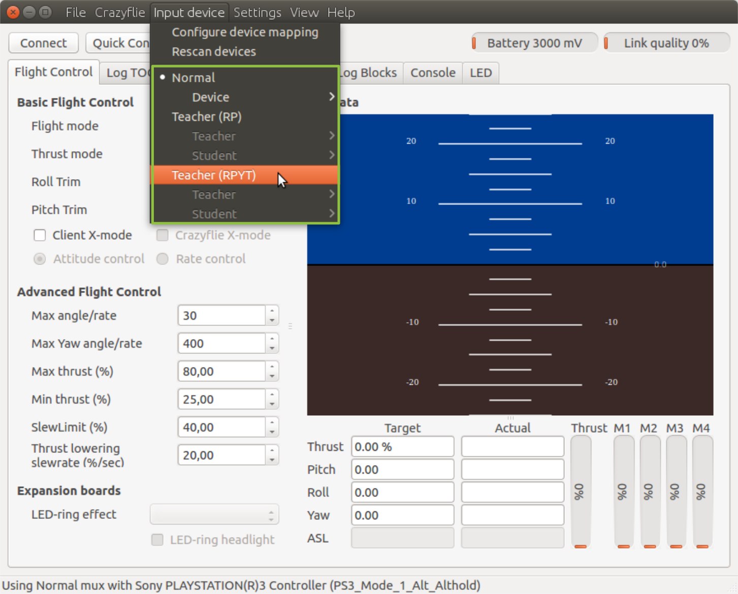

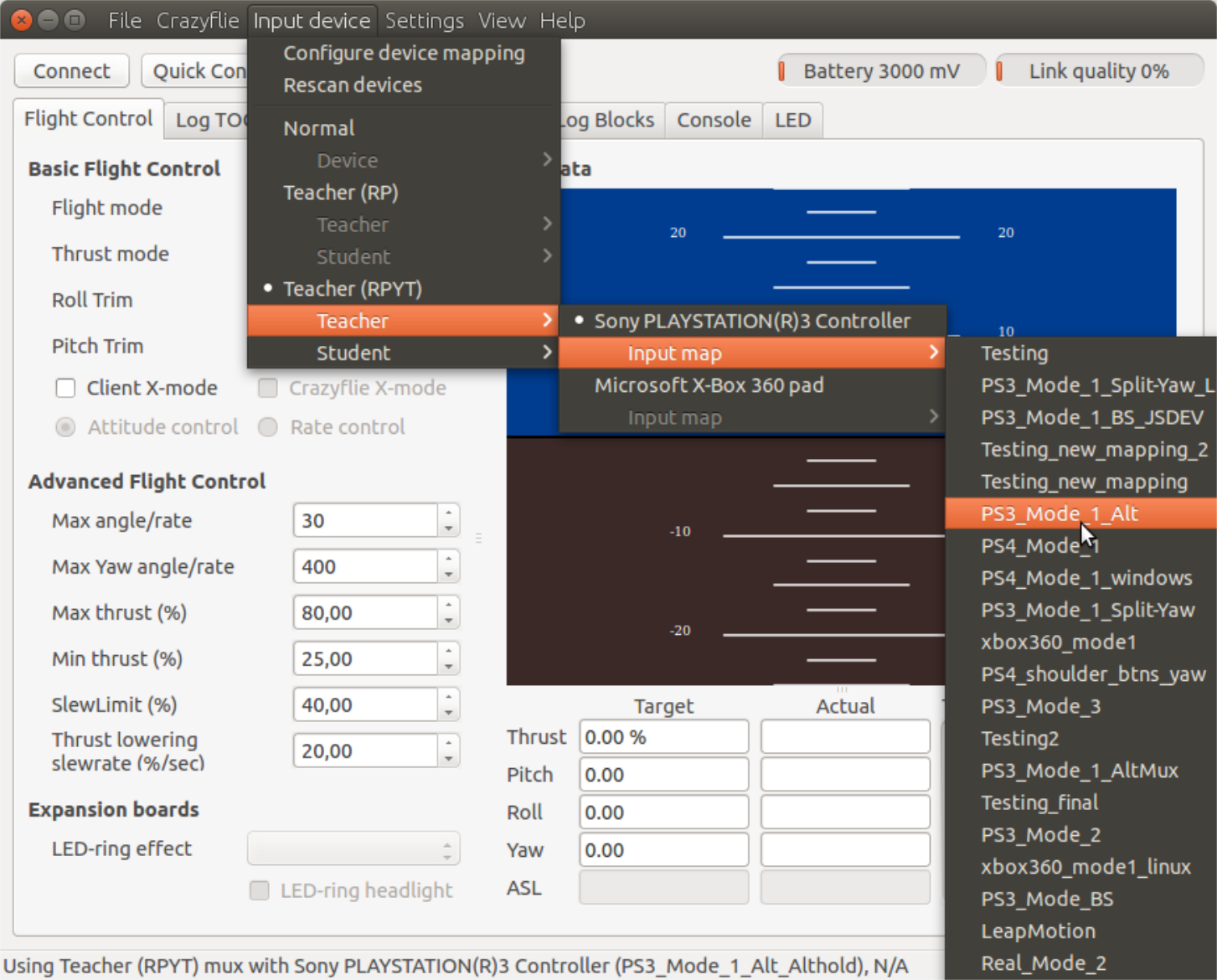

Selecting device
The current input device and mapping can be selected from the Input device menu.
The Input device menu contains a number of different "modes" that can be used for controlling a Crazyflie. Currently there's thee to choose from. The alternatives will only be enabled if there's enough input devices connected to use them.
- Normal: Just like it says this is the normal mode using only one controller to control a Crazyflie
- Teacher (RP): This mode requires two input-devices, where one will be configured for roll and pitch and the other one for the rest of the functionality. By using the Mux switch functionality (mapped in the configuration) the second controller can take over roll and pitch as well
- Teacher (RPYT): This mode requires two input-devices, where one will be configured for roll, pitch yaw and thrust, and the other one for the rest of the functionality. By using the Mux switch functionality (mapped in the configuration) the second controller can take over roll, pitch, yaw and thrust as well
For normal usage just enter the Normal menu, select the device you would like to use and the correct mapping. As a device is selected the list of mappings are enabled.
If more than one input device is connected then it's possible to switch to one of the teacher modes.
First select the device that should be used for the teacher and then it's mapping.
Then select the device that should be used for the student and then it's mapping.

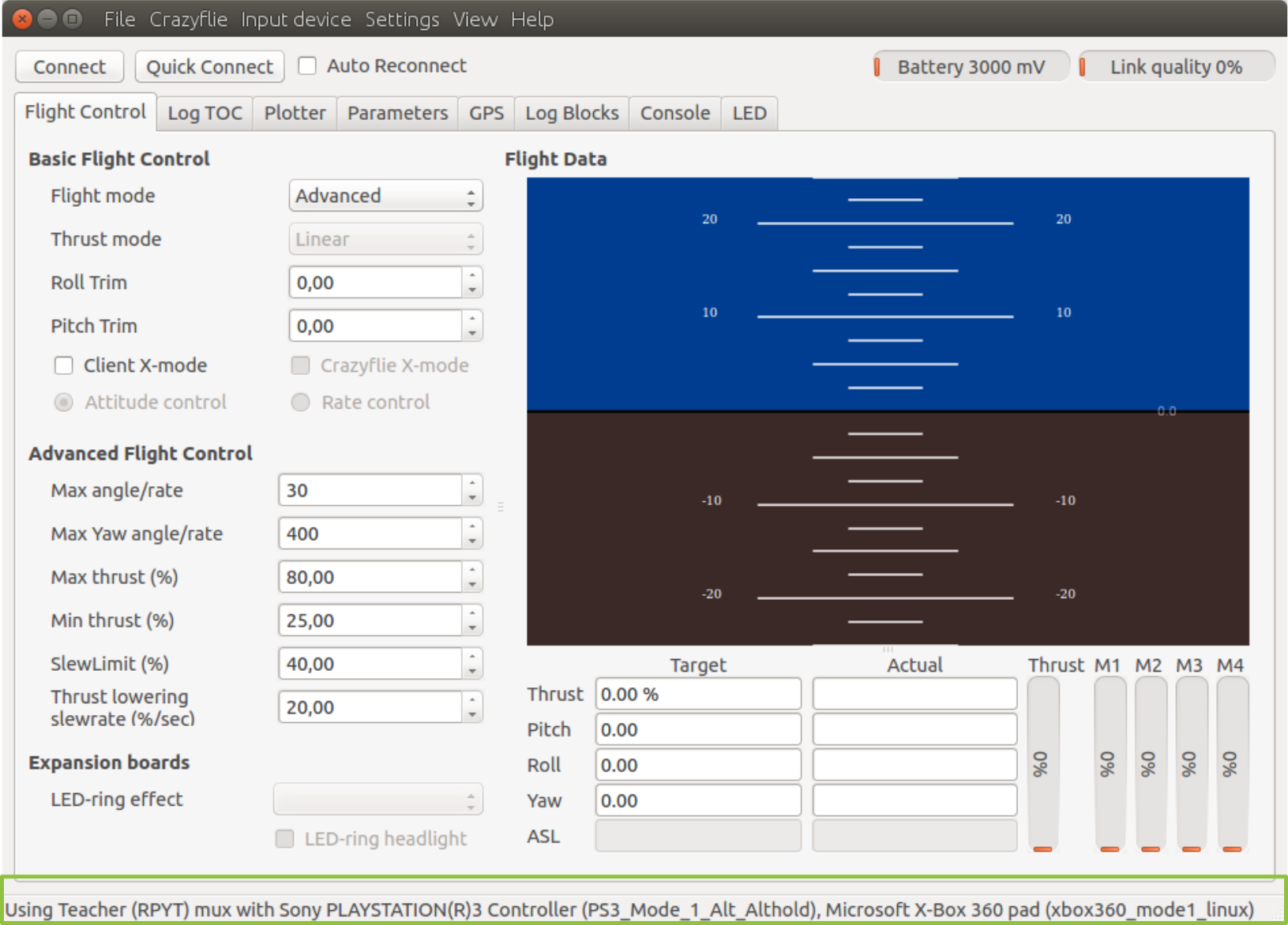

Once this is done you will be able to see the open devices and configurations at the bottom of the user interface.
