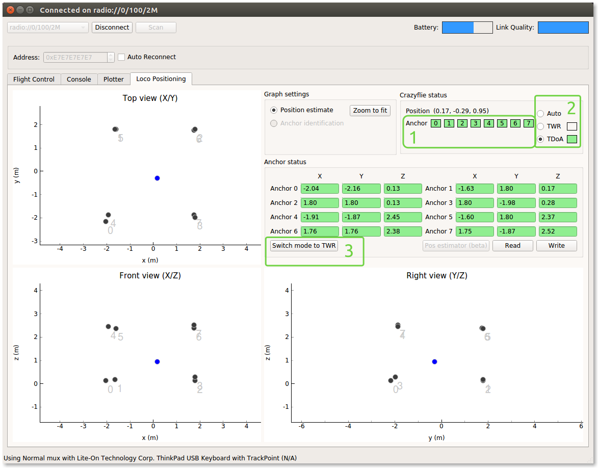

Using the client, connect a Crazyflie with a LocoDeck installed. When connected open the Loco Positioning System tab:
cfclient switch anchor mode
  1. Make sure your Crazyflie has good connection and clear line of sight with all the anchors. Ideally place it in the center of the flying space. Make sure that the status of all the anchor is a solid green in the tab.
  2. Using the radio button (2), select the mode on which the system is currently running. TWR or TDoA.
  3. Click the switch buttons (3). The status (1) of all the anchors should switch red.
  4. Using the radio button (2), select the new mode, the anchor status (1) should switch back to green. Your Crazyflie is now getting its position using the new mode!

If some of the status boxes do not go back to green after the switching procedure, it indicates that the anchors did not change mode and you have a system with mixed modes. A system with mixed modes will not work.
I want my system in TDoA mode but some anchors are left in TWR mode
  1. Select TWR mode using the radio button (2).
  2. Click on the switch button (3). The status (1) of all the anchors still in TWR mode should turn red. You can click on the button (3) multiple if required.
  3. Select TDoA mode using the radio button (2). All anchors should now be in TDoA modes.
