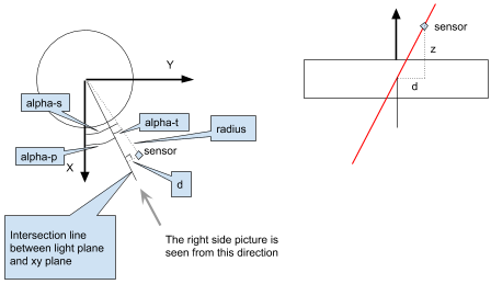

To calculate the predicted rotation angle αp\alpha_p we have to go from the sensor position (sr=(x,y,z)s_r = (x, y, z) in the rotor reference frame) to rotation angle, where the rotation angle is from the X-axis to the line where the light plane intersects the XY-plane. The rotation angle to the sensor αs\alpha_s is the sum of the predicted rotation angle αp\alpha_p and the rotation angle from the intersection line to the sensor αt\alpha_t, caused by the tilt of the light plane, αs=αp+αt\alpha_s = \alpha_p + \alpha_t
Prediction geometry
The rotation angle to the sensor αs\alpha_s is defined by
tan⁡αs=yx\tan \alpha_s = \frac{y}{x} αs=tan⁡−1(yx)\alpha_s = \tan^{-1}(\frac{y}{x})
To calculate αt\alpha_t we first have to look at the sensor position projected on the XY-plane (x,y,0)(x, y, 0). The radius to this point is r=x2+y2r = \sqrt{x^2 + y^2}
We also need the distance dd from the intersection line to the sensor, perpendicular to the intersection line, d=rsin⁡αtd=r\sin \alpha_t.
dd can also be calculated using the tilt and z, d=ztan⁡−td=z\tan -t. If we combine these
rsin⁡αt=ztan⁡−tr\sin \alpha_t = z\tan -t sin⁡αt=ztan⁡−tr=−ztan⁡tx2+y2\sin \alpha_t = \frac{z\tan -t}{r} = -\frac{z\tan t}{\sqrt{x^2 + y^2}} αt=sin⁡−1(−ztan⁡tx2+y2)=−sin⁡−1(ztan⁡tx2+y2)\alpha_t = \sin^{-1}(-\frac{z\tan t}{\sqrt{x^2 + y^2}}) = -\sin^{-1}(\frac{z\tan t}{\sqrt{x^2 + y^2}})
Finally we can calculate the predicted rotation angle
αp=αs−αt=tan⁡−1(yx)+sin⁡−1(ztan⁡tx2+y2)\alpha_p = \alpha_s - \alpha_t = \tan^{-1}(\frac{y}{x}) + \sin^{-1}(\frac{z\tan t}{\sqrt{x^2 + y^2}})
