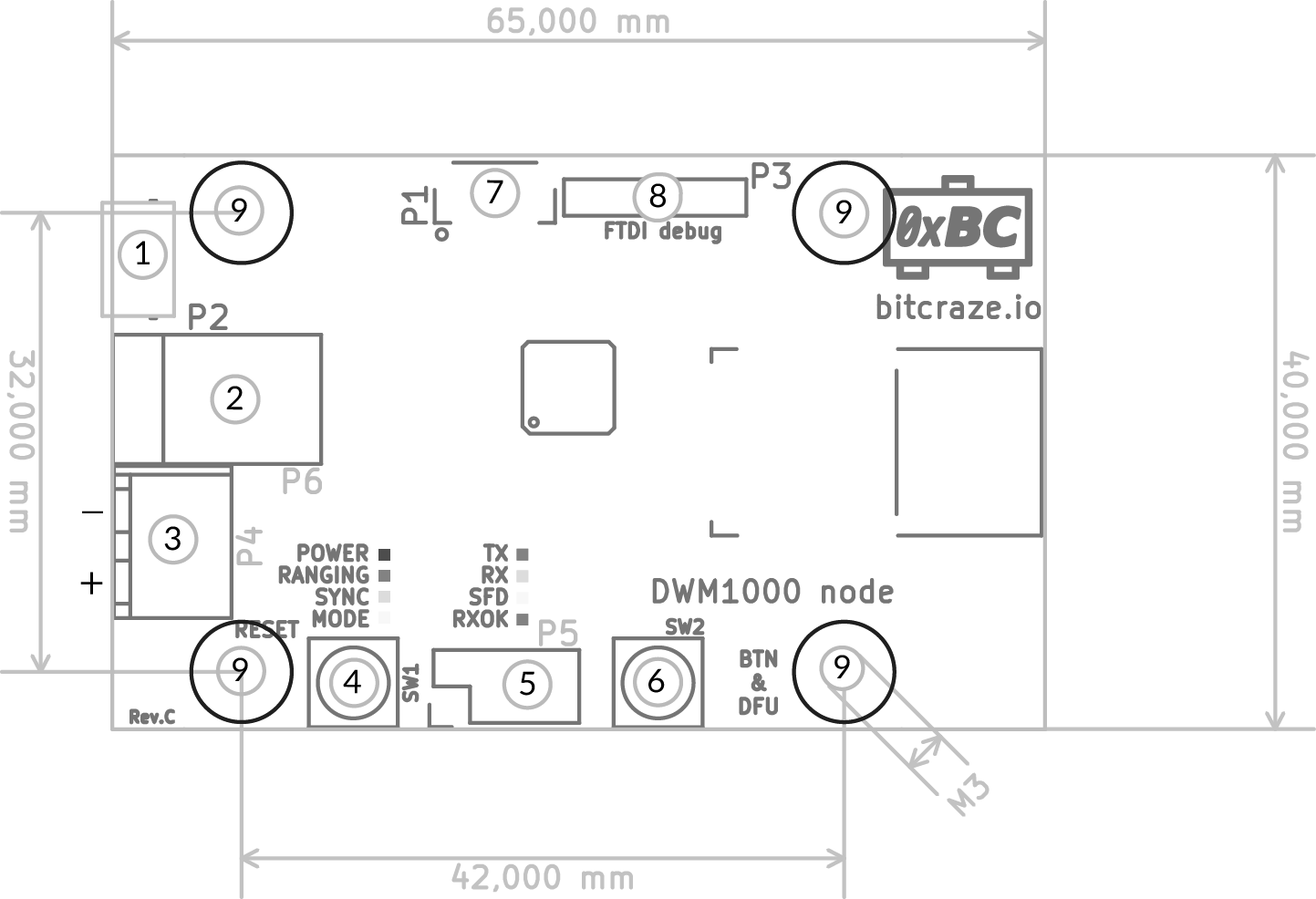

| ID | Type | Description |
| 1 | Connector | micro-USB for power and communication |
| 2 | Connector | DC-jack (5V) |
| 3 | Connector | Terminal (5V) |
| 4 | Button | Reset |
| 5 | Connector | Designed for ESP8266 but can be used for other things. Note: Pin-out changed between RevD and RevE (see blow) |
| 6 | Button | If pressed and held during reset or power on this will put the board into DFU bootloader mode. When the system is up and running the button is unused, but could be used to trigger functionality in the firmware. |
| 7 | Connector | SWD connector for programming and debugging MCU. Uses same pin-out as Crazyflie 2.X. |
| 8 | Connector | For FTDI serial-to-USB cable (TTL-232R-3V3). Can be used as a serial port for debugging and to power the board. Note that signals are 3V3 and power is 5V. |
| 9 | Mounting | M3 mounting holes |
LED legend:
| LED | Color | Controlled by | Description |
| POWER | Blue | MCU | On when board is powered |
| RANGING | Red | MCU | Blinking when ranging is in progress |
| SYNC | Green | MCU | TDB |
| MODE | Yellow | MCU | On in Anchor mode, off in Tag mode and blinking in Sniffer mode |
| TX | Red | DWM1000 | Transmitting |
| RX | Green | DWM1000 | Receiving |
| SFD | Yellow | DWM1000 | Received packet timestamp |
| RXOK | Red | DWM1000 | Packet received without error |
