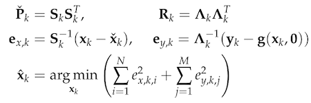

Therein, xkx_k and yky_k are the system state and measurements at timestep k, PkP_k and RkR_k denote the prior covariance and measurement covariance, respectively. Through Cholesky factorization of PkP_k and $$R_k$ $, the original optimization problem is equivalent to:
equation
where ex,k,ie_{x,k,i} and ey,k,ie_{y,k,i} are the elements of ex,ke_{x,k} and ey,ke_{y,k}. To reduce the influence of outliers, we incorporate a robust cost function into the Kalman filter framework as follows:
