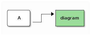

Diagrams
Ditaa (DIagrams Through Ascii Art) generates images from ascii art, it is convienient to use for simple diagrams or protocol descriptions. Read the ditaa documentation for a description of the supported features.
The ditaa markup must be enclosed in liquid tags. The alt text is required since the diagram is rendered as an image, it is used as support for disabled readers, search engines and other tools. Use a text that describes what the diagram illustrates.
{% ditaa --alt "Example diagram" %}
|       |   +--->| cGRE    |
|   A   |   |    | diagram |
{% endditaa %}
and will be rendered like this
Example diagram
