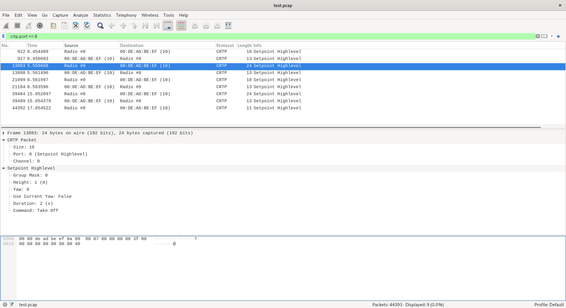

We have written a plugin to Wireshark that can display CRTP packets (what this library uses to communicate with Crazyflies).
Image of CRTP dissector in Wireshark

To generate a PCAP file and open it with Wireshark. You can also use the text based tshark tool, and you can add a filter, for instance, only shoow CRTP port 8 (Highlevel setpoint):
$ tshark -r test.pcap "crtp.port == 8"
