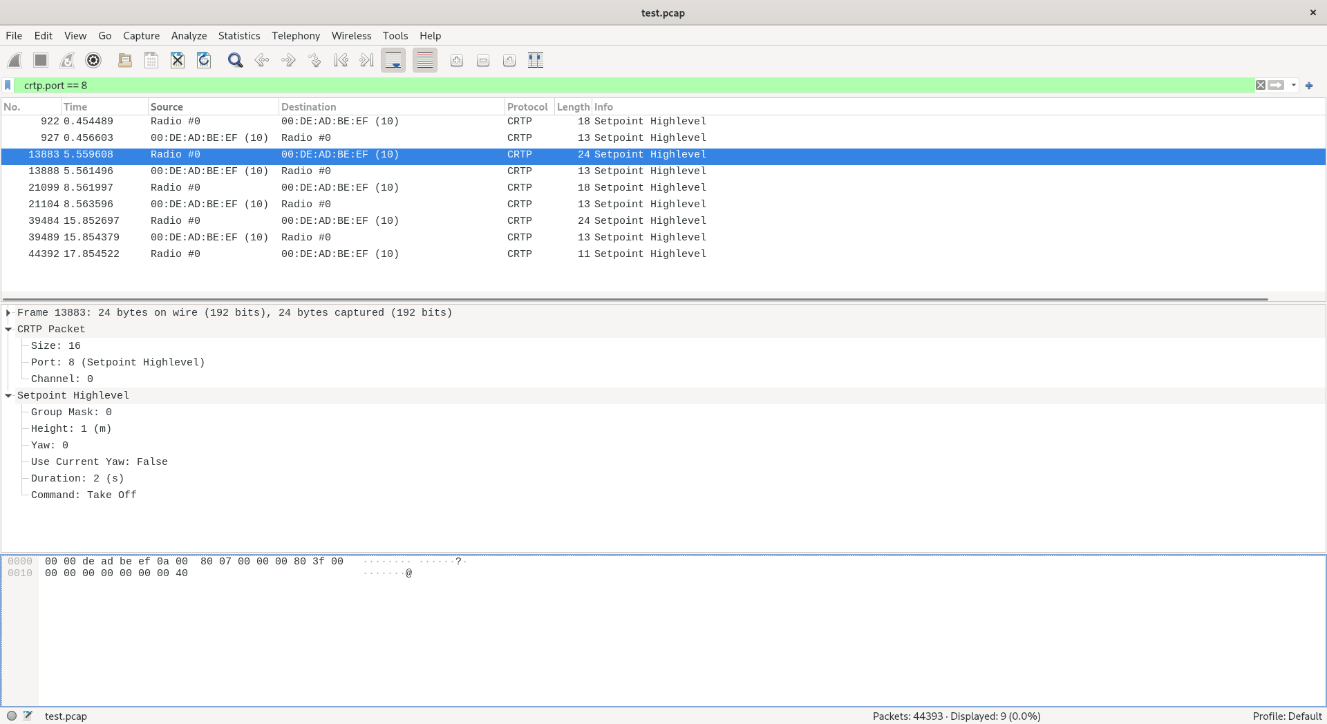

We have written a plugin to Wireshark that can display CRTP packets (what this library uses to communicate with Crazyflies).
Image of CRTP dissector in Wireshark
In order for Wireshark (and our dissector plugin) to be able to decode CRTP you need to do two things:
1. Install the plugin crtp-dissector.lua

Copy the tools/crtp-dissector.lua file into the personal plugin folder and restart Wireshark or hit CTRL+SHIFT+L

To tell the CFLIB to generate a PCAP file of what it thinks the CRTP traffic looks like you can go:
$ CRTP_PCAP_LOG=filename.pcap python3 examples/swarm/hl_commander_swarm.py
$ wireshark filename.pcap
and on Windows based computers in a shell window:
> set CRTP_PCAP_LOG=filename.pcap
To generate a PCAP file and open it with Wireshark. You can also use the text based tshark tool, and you can add a filter, for instance, only shoow CRTP port 8 (Highlevel setpoint):
$ tshark -r test.pcap "crtp.port == 8"
