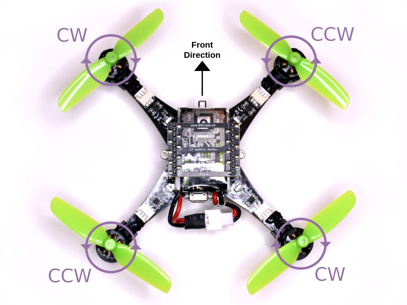

They need to be mounted on the correct arm. As a guide, you’ll find arrows next to each motor on the PCB.
Attaching:
  • Make sure that the correct side is facing up, the top side should be convex.
  • The arrow on the arm of the Crazyflie indicates what rotation direction the propeller should have.
Here’s a detailed view of where to attach CW and CCW propellers.
Crazyflie propeller mounting

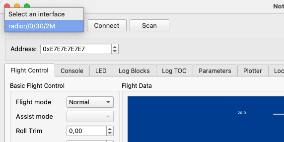

Connect to the Crazyflie
When you have set up the client, insert the Crazyradio 2.0  in your USB-port, connect the gamepad and then start the client.
  • In the Crazyflie client enter the correct Address. The default one for a new Crazyflie out of the box is 0xE7E7E7E7E7. To figure out or change the Address of your Crazyflie, you can follow the radio address configuration guide.
  • Then, with your Crazyflie powered on and radio connected, click the Scan button in top left corner. The radio settings for your Crazyflie are displayed in the drop-down list.
  • Choose your Crazyflie from the drop-down list.
  • Click the Connect button.
Connect dialog

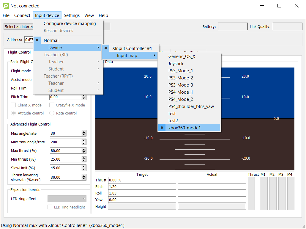

Configure your gamepad
You can use any gamepad connected to your computer by cable or Bluetooth. The gamepad has to be connected before you start the client to be recognized by the client. After you have connected your gamepad, open the input device settings in the client. Check if the correct device mapping is chosen, otherwise pick your device type.
Gamepad settings
For more detailed information on input devices, see the Client user-guide. In this guide it is also shown how to configure your own device mapping to perfectly suit your gamepad.

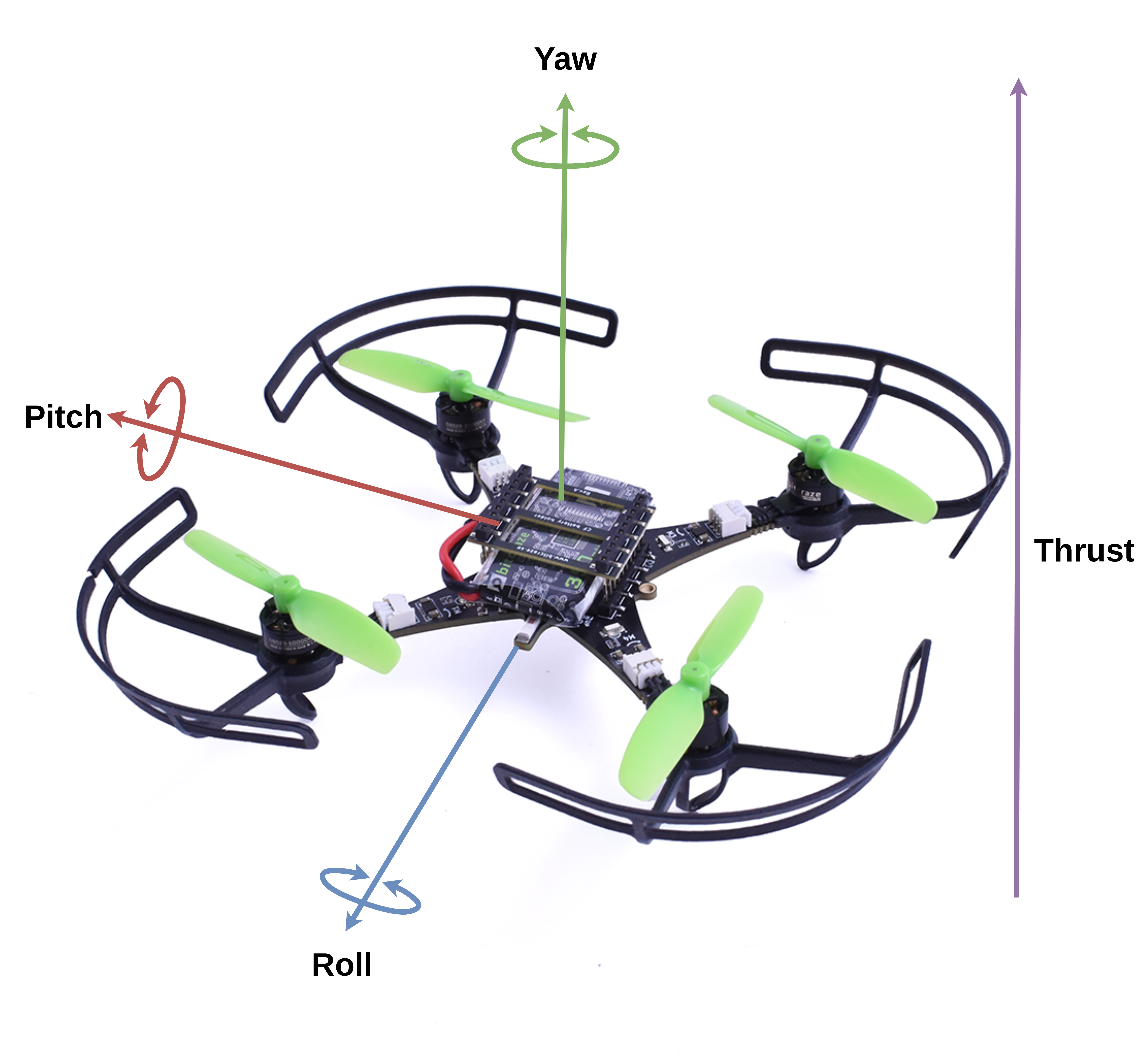

Maneuvering a quadcopter
When flying a quadcopter there are four main dimensions of controls; roll, pitch, yaw and thrust.
Axis
  • Roll - is the rotation around a horizontal axis going through the quadcopter from back to front. This rolls the Crazyflie and moves it left or right.
  • Pitch - is the rotation around a horizontal axis going through the quadcopter from left to right. This tilts the Crazyflie and moves it forwards or backwards.
  • Yaw - is the rotation around a vertical axis. This rotates the quadcopter left or right. Yaw is used when changing flying direction by pointing the front of the Crazyflie in different directions.
  • Thrust - adjusts the altitude, or height, of the Crazyflie.
Lear more about the coordinate system of a Crazyflie here.
Gamepad controls
The controls on the gamepad have multiple different input mappings to select from. A common mapping to use in a lot of flying robotics applications is mapping 3, and it is mapped the following way:
Control mapping
To change between mappings and gamepad types as well as creating your own custom mapping check out the documentation for input devices.
