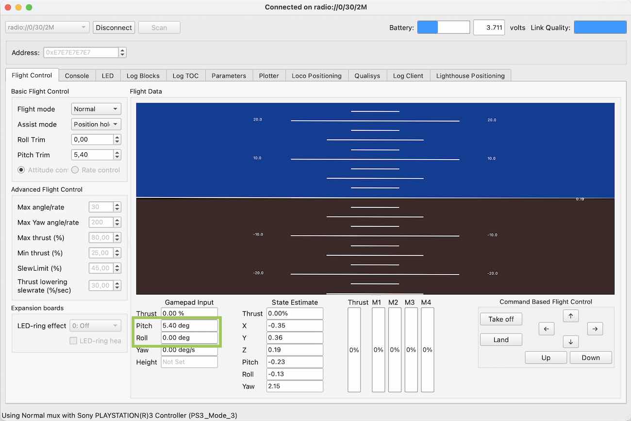

Verify the gamepad
  • Center the sticks on the gamepad
  • In the Target area of the Flight tab, verify that Pitch and Roll is [0.0]. If they are not zero the consequence will be that the Crazyflie slowly moves when the sticks are released which might not be the wanted behavior.
Crazyflie pitch roll
Here you can see that the Pitch and Roll is not [0.0] which might result in the Crazyflie drifting when the sticks are released.
