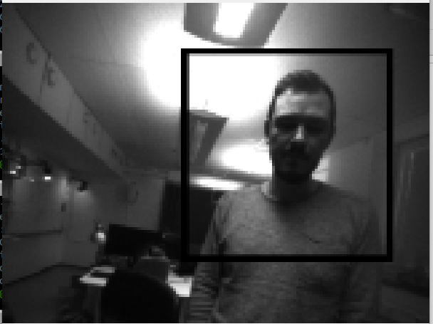

Now you should see something like this:
Note that the face detection does not work great under all conditions - try with a white background and dark hair…
