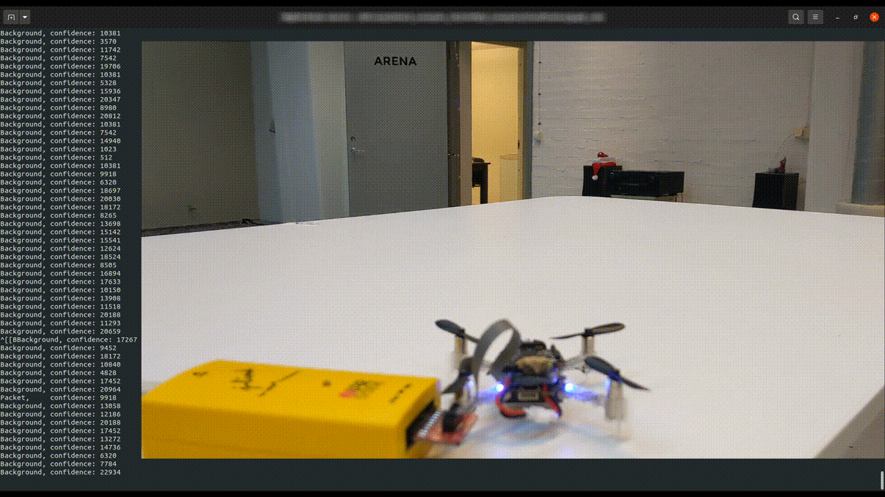

classification Screen recording showing terminal classification output alongside an external camera view of the setup
