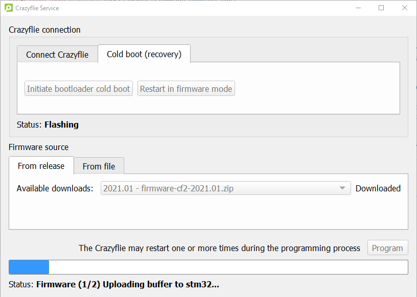

To update the firmware in the Crazyflie 2.X do the following:
  • Make sure that the Crazyflie is disconnected from the client and powered off.
  • Go to the menu Crazyflie->Bootloader
  • Select the "Cold boot (recovery)" tab in the dialog.
  • Press and hold the power button on the Crazyflie for about 3 seconds. The blue LED (M2) starts to blink to indicate the Crazyflie is in bootloader mode. If a wrong nRF51 firmware has been flashed you might have to start from an un-powered state. Then hold the button and connect power.
  • Click "Initiate bootloader cold boot" in the client
  • Select the latest release from the drop down menu or the file if you have downloaded it from the Github release page.
  • Press "Program" and wait (do not restart the crazyflie until it is finished.)
  • Press "Restart in firmware mode"
