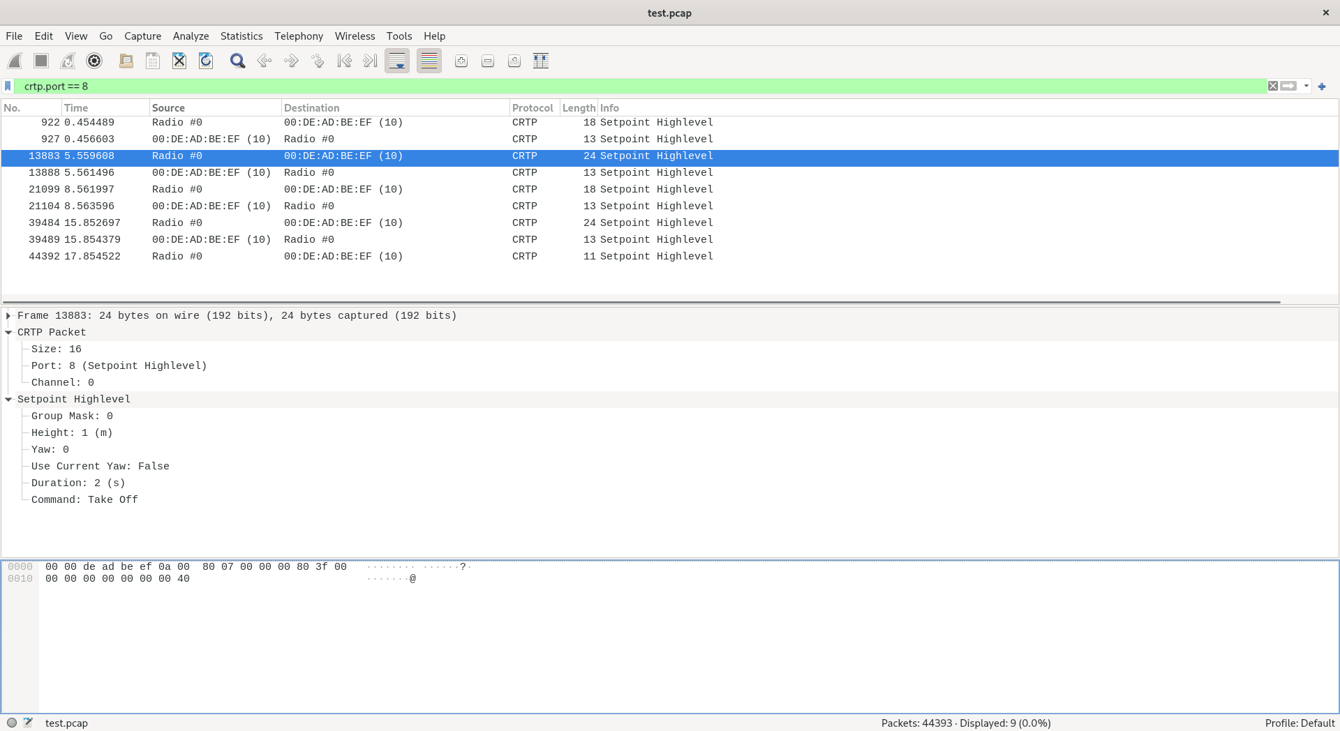

We have written a plugin to Wireshark that can display CRTP packets (what this library uses to communicate with Crazyflies).
Image of CRTP dissector in Wireshark
In order for Wireshark (and our dissector plugin) to be able to decode CRTP you need to do two things:
