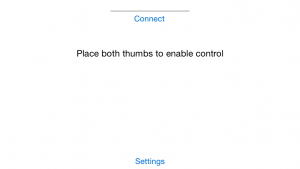

The main screen allows to connect the Crazyflie 2.X by clicking connect. When connected the button is changed to “disconnect” and the top progress bar is filled up.

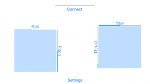

To start flying place both thumb on both side of the screen. Two blue square appears, they represent two touch joystick.
main screen main screen joysticks

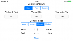

The control sensitivity and joystick mapping (control mode) is available clicking the settings button:
config screen
