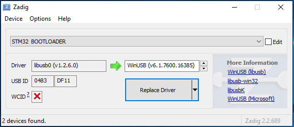

To access the LPS-node from the usb on a windows machine, follow the same instructions as the protocol decribed in the crazyradio firmware. The only difference is that the Zadig window would need to like the following image.
