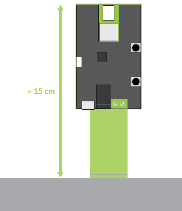

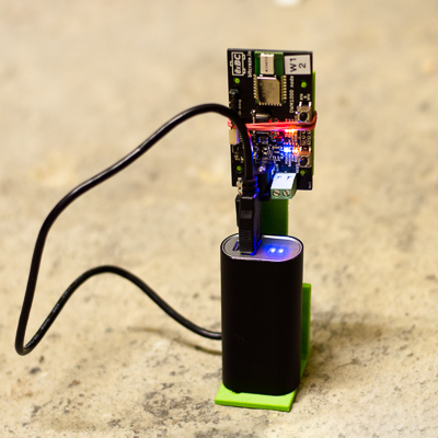

The nodes should be placed at least 15 cm away from walls or ceiling. In our reference set-up we accomplish this by using these 3D printed stands.
Power the anchors with 5V using either the micro-USB connector, the terminal or the DJ-jack.
