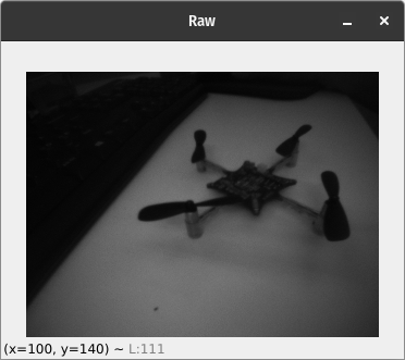

In order to view the images from the GAP8 connect to the WiFi access point on the deck and run the following:
$ cd aideck-gap8-examples/examples/other/wifi-img-streamer
$ python opencv-viewer.py
Then you should be able to see the raw/color or jpeg image in the viewer like this:
Note: If you like to save the images, you can run the opencv-viewer.py with the --save flag.
