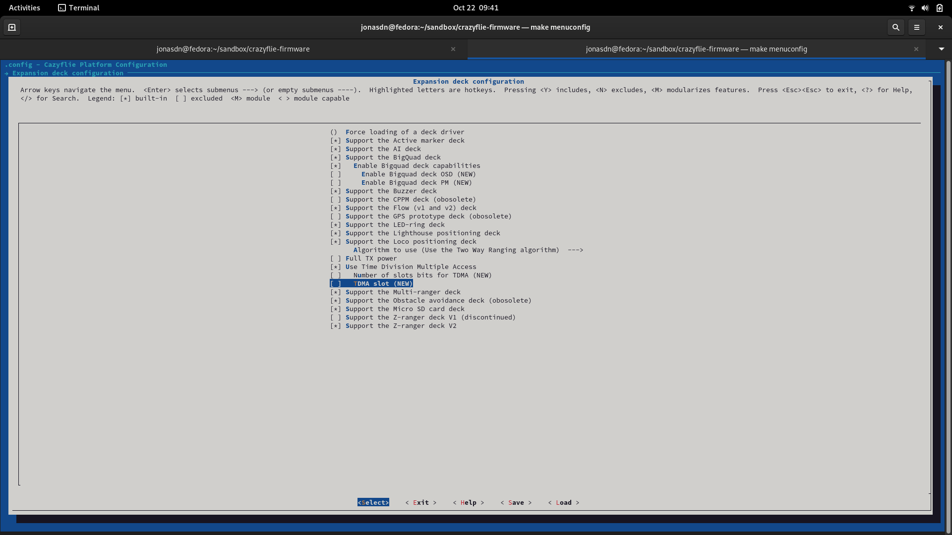

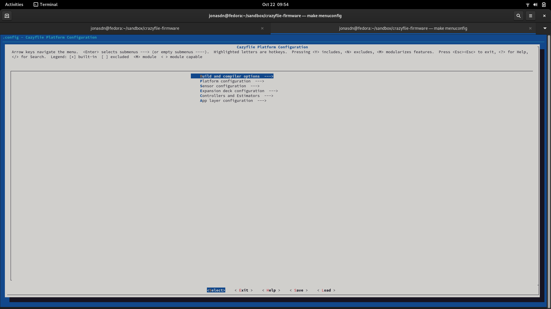

To get an idea of how menuconfig will look, please see the images below.
Main menu of menuconfig
Configuring deck drivers
