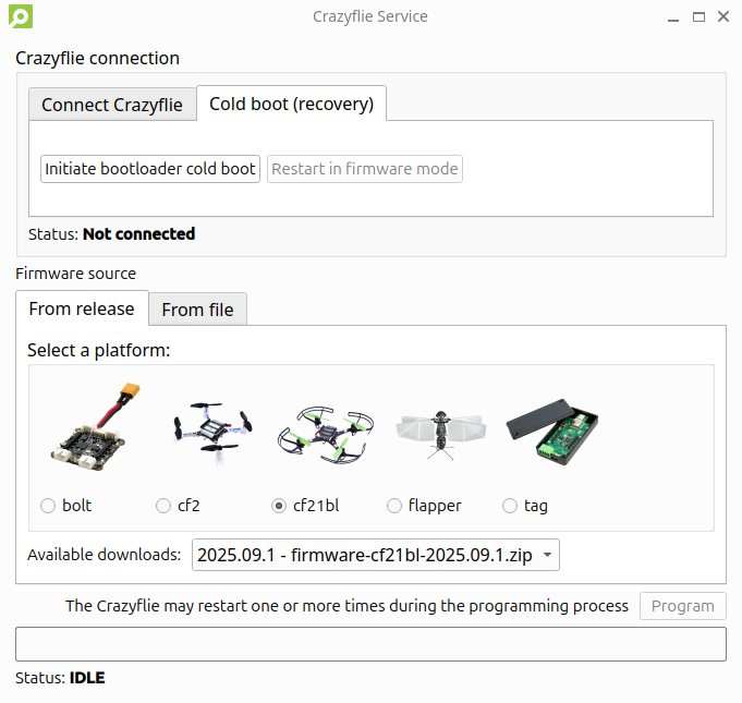

To update the firmware in the Crazyflie 2.x do the following:
  • Make sure that the Crazyflie is disconnected from the client and powered off.
  • Go to the menu Crazyflie->Bootloader
  • Select the "Cold boot (recovery)" tab in the dialog.
  • Press and hold the power button on the Crazyflie for about 3 seconds. The blue LED (M2) starts to blink to indicate the Crazyflie is in bootloader mode.
    • If this does not work, for example if a wrong nRF51 firmware has been flashed, try starting from an un-powered state. Do this by holding the power button and then connecting to power (connecting the battery).
  • Click "Initiate bootloader cold boot" in the client
  • Select the latest release from the drop down menu or the file if you have downloaded it from the Github release page.
  • Press "Program" and wait (do not restart the Crazyflie until it is finished.)
  • Press "Restart in firmware mode"
