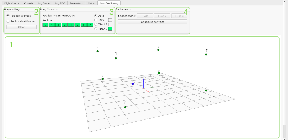

Position estimate mode
Displays the configured anchor positions and the estimated position of the Crazyflie. Can be used to make sure the system is set up correctly and that the estimated position is reasonable.
cfclient positioning
  1. Plot showing anchors and Crazyflie
  2. Sets the graph mode
    • Position estimate - Normal viewing mode
    • Anchor identification - Enhanced mode where anchor id and marker becomes larger when Crazyflie is closer
  3. Indicates if anchors are communicating with Crazyflie (i.e anchors are up and running)
  4. Used to set anchor positions and change mode of the system

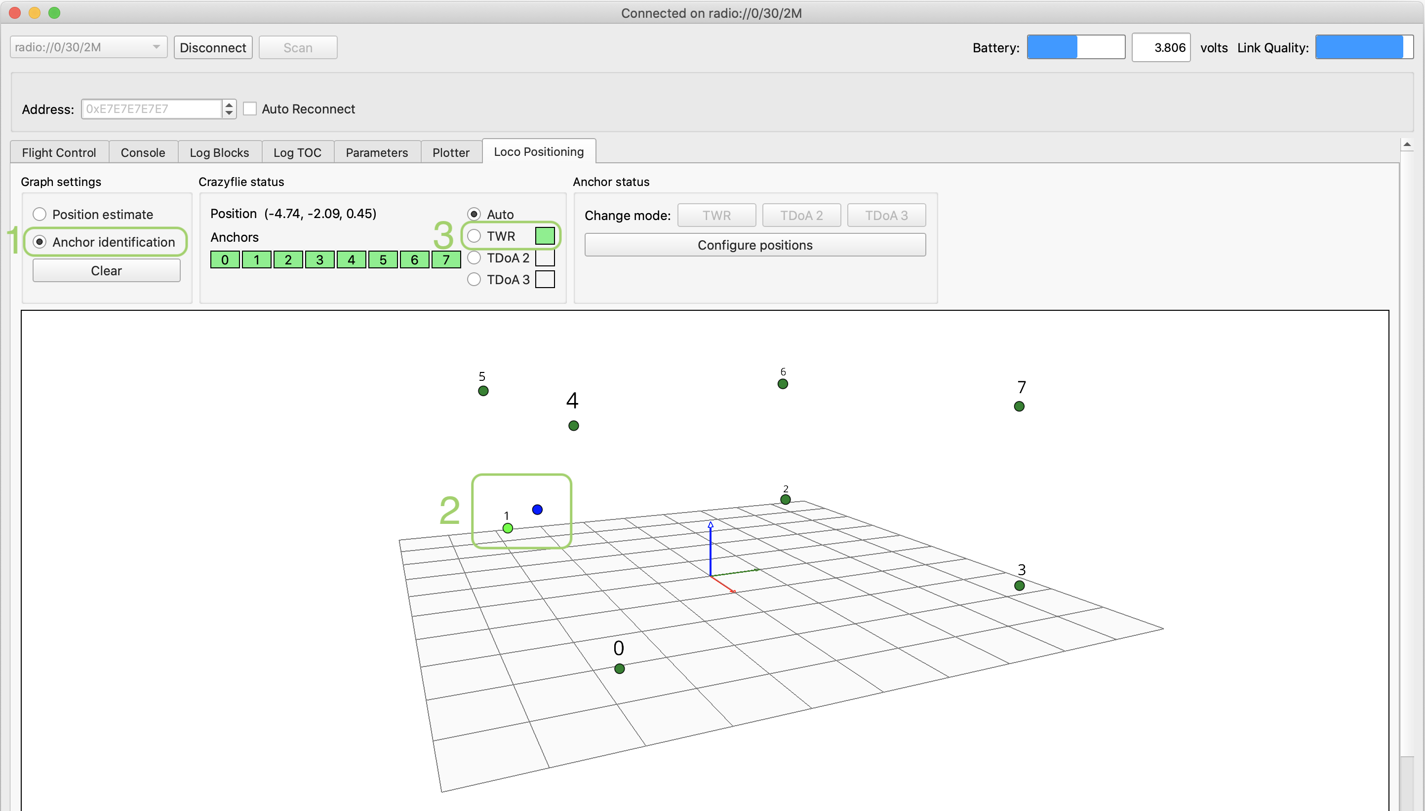

Anchor identification mode
displays the configured anchor positions. When the crazyflie is close to an anchor this is indicated in the graphs by highlighting it. This mode is useful to identify anchors and verify that the system is correctly configured. NOTE: Only orks in TWR mode.
cfclient anchors
  1. Sets the graph mode
    • Anchor identification - Enhanced mode where anchor id and marker becomes larger when Crazyflie is close to an anchor
  2. Plot showing anchors and Crazyflie. In this example anchor 1 is close to the Crazyflie.
  3. Current system mode indication. The system must be in TWR mode for the anchor identification mode to be available.
