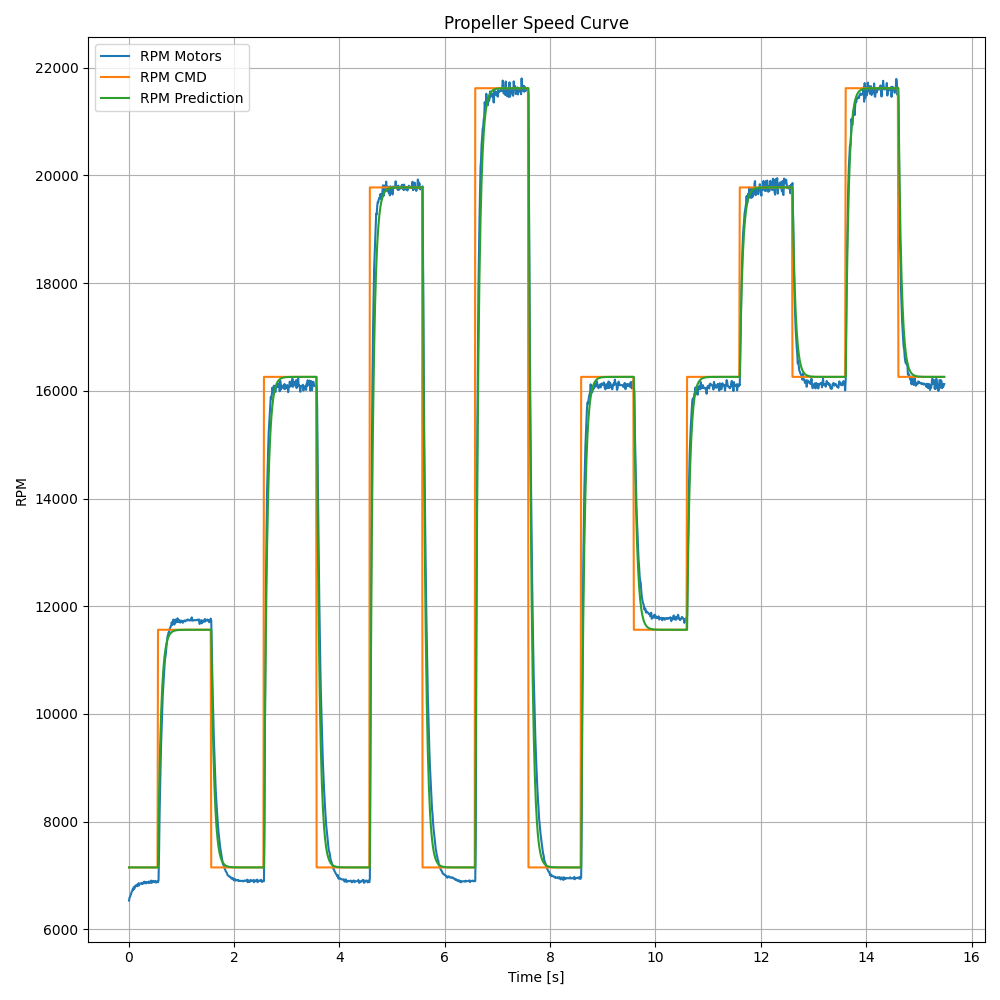

Dynamic Behavior
To obtain a complete parameter set of the motors and propellers, dynamic tests were performed which included commanding rapid increases and decreases in PWM and measuring the thrust response.
dynamic RPM
These dynamics are not required for the battery compensation itself, but they are very useful for accurate system identification and for simulation purposes.
