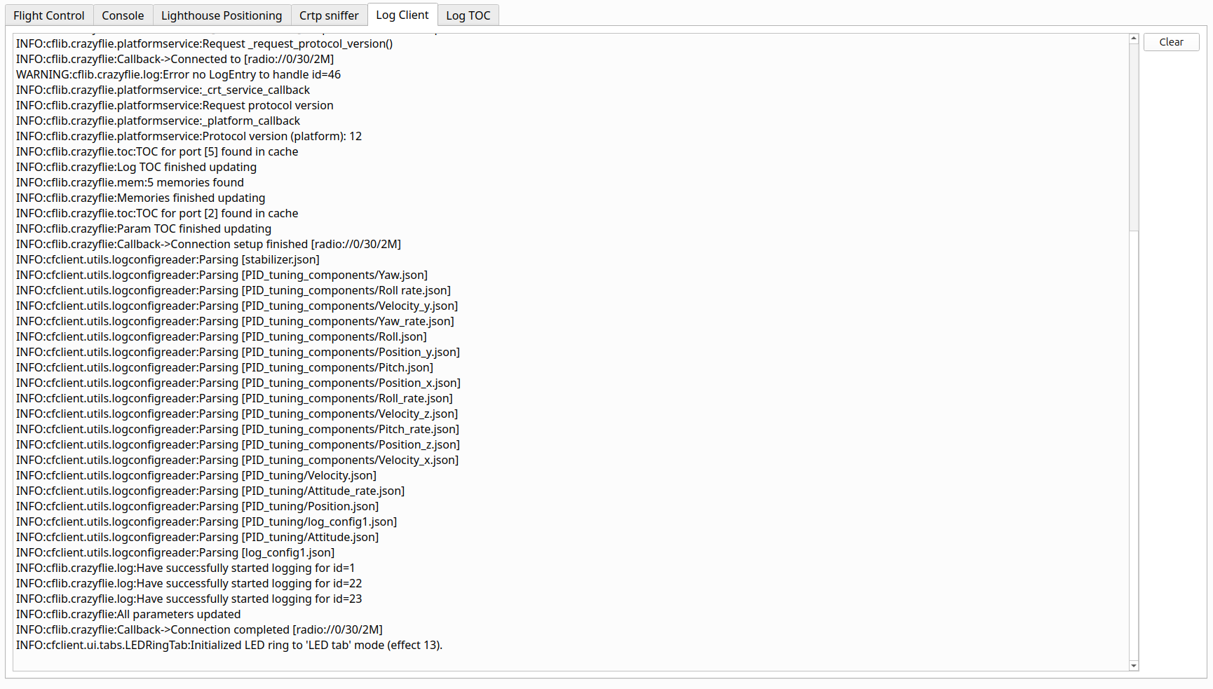

Log Client Tab
The log client tab displays log messages produced by the client itself, such as connection events, device scans, and gamepad detection. It is useful for diagnosing client-side issues.
Log messages are shown in the format LEVEL:LOGGER:MESSAGE, for example:
INFO:cfclient.ui.main:Connected to radio://0/80/2M
WARNING:cfclient.ui.tabs.FlightTab:No input device found
Controls:
  • Clear: Removes all messages from the display.
cfclient log client tab
