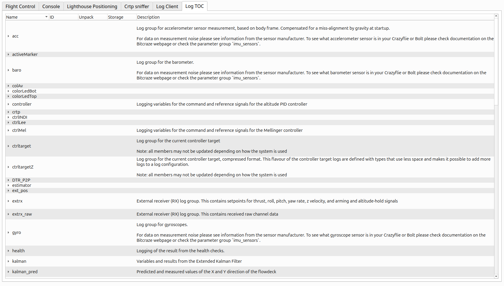

Log TOC Tab
The log TOC (Table of Contents) tab shows all log variables available on the connected Crazyflie. It is a read-only reference for what can be logged — use the Log Blocks tab to configure and start logging.
Variables are grouped by category and displayed in a sortable tree.
cfclient log TOC tab
  1. Fields
    • Name: The variable or group name
    • ID: Numerical identifier of the variable on the Crazyflie
    • Unpack: Python type used to unpack the received data
    • Storage: C type used to store the value on the Crazyflie
    • Description: Short description of the variable, if documentation is available
  2. The tree is grouped by category. Expanding a group shows all variables within it.
The tab is populated automatically when a Crazyflie connects and cleared when it disconnects.
