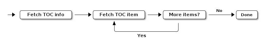

State machines
Downloading the Table of Contents
crtp log
Table of Contents access
  • Port: 5
  • Channel: 0
This channel is used to download the Table of Contents (TOC) that contains all the variables that are available for logging and what types they are.
The first byte of each message’s payload corresponds to a command. All communication is initiated by the client and all answers from the copter will contain the same command byte.
