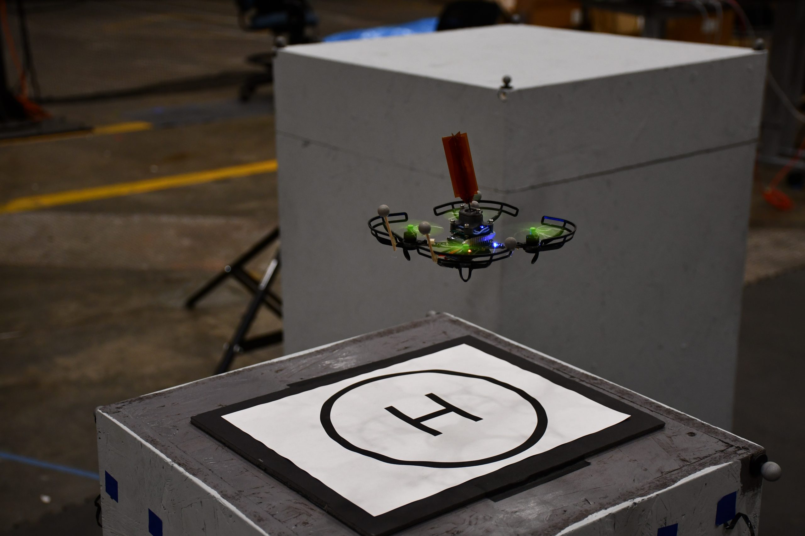

To accomplish that, we used the WindShaper facility at NASA Ames Research Center in Mountain View, CA, a state-of-the-art open-air wind tunnel (the “WindShaper”) positioned inside a basketball court-sized motion capture space. We mimicked “urban winds” using wooden boxes meant to represent buildings.
The problem was that the WindShaper was only so big. We needed a similarly scaled drone that could represent our eVTOL. That’s where the Crazyflie came in!

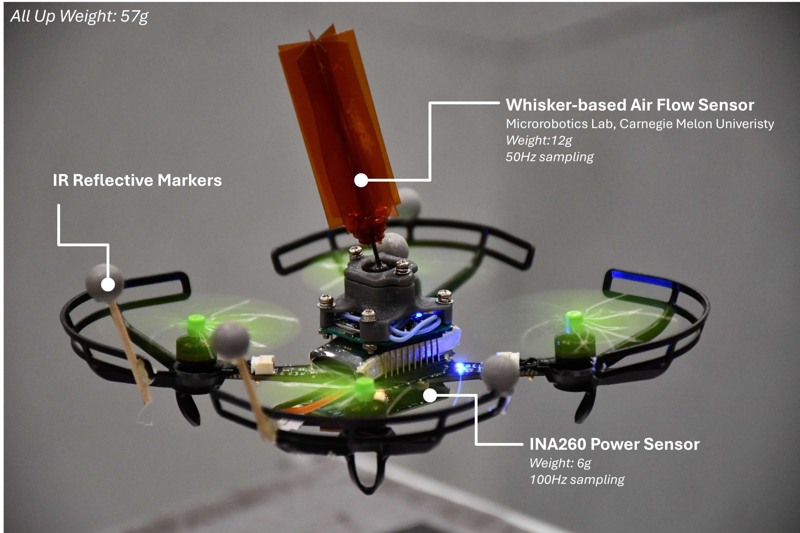

We modified the Crazyflie with two additional sensors. The first was an INA260 power sensor that we used for… well, measuring the power draw from the battery! The second sensor was a bit more interesting. In partnership with the Microrobotics Lab at Carnegie Mellon University, we put a whisker-based air flow sensor on the Crazyflie to measure the wind. You can read more about that neat sensor here.
The all up weight, including the battery, power sensor, whisker, and motion capture markers was 57g, almost double the standard weight. With a 350mAh battery we could get about 3 to 5 minutes of flight, depending on the wind speed, which was just enough time for us to run our experiments.

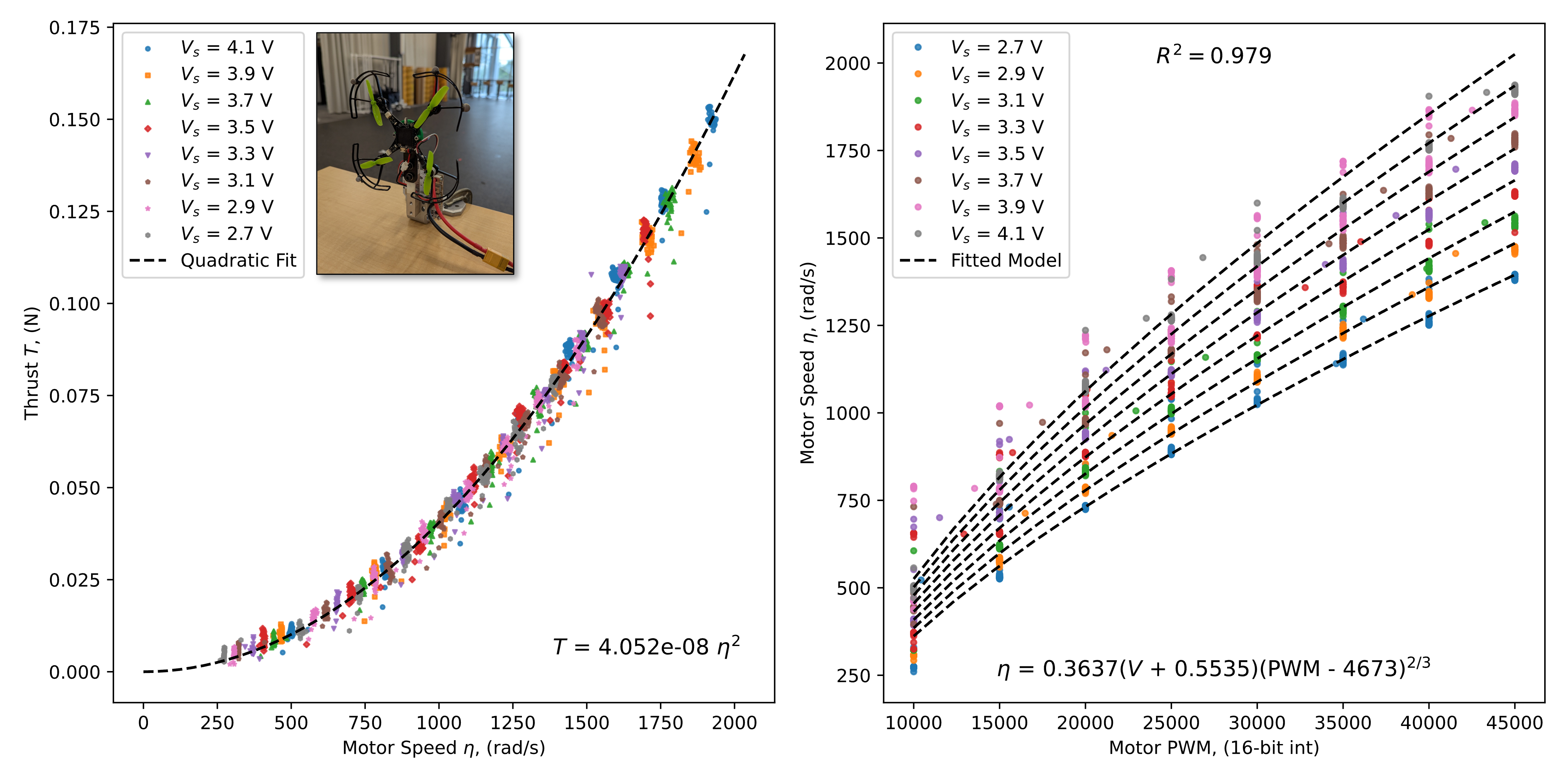

I did two experiments to characterize the brushless Crazyflie. The first experiment involved strapping the Crazyflie onto a thrust stand with an optical RPM sensor to model the relationships between thrust, speed, commanded PWM signal, and battery supply voltage. The last three signals were relevant because at the time the firmware didn’t support direct motor speed measurements!

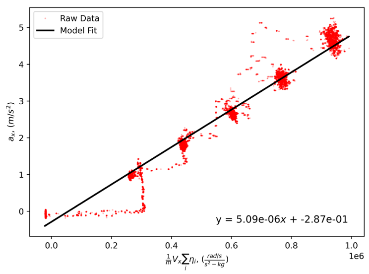

The second experiment involved subjecting the Crazyflie to wind speeds varying from 0 m/s up to 8 m/s. For these experiments, I used the onboard accelerometer to measure the net drag force, which required being able to subtract the static thrust from the propeller, hence the previous experiment; the INA260 sensor to measure power draw from the battery; and a combination of motion capture and a pitot-static probe on a tripod to measure the drone’s ground speed and wind speed, respectively.
The plot above shows a surprisingly linear relationship between the acceleration and the sum of airspeed and motor speeds for the x body axis. This is known as rotor drag, and it’s generally considered the dominant form of drag for quadrotors at lower airspeeds. The slope of this line is the rotor drag coefficient. What this model lets us do is infer the airspeed along the x axis from the accelerometer and motor speeds alone, no dedicated wind sensor necessary!

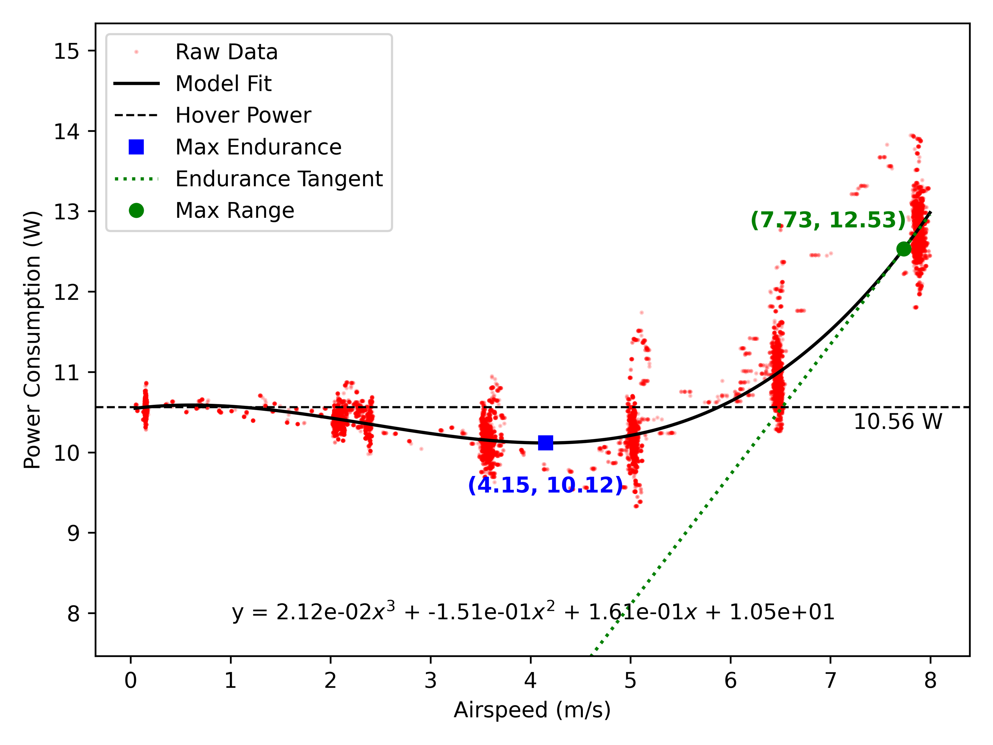

Lastly, I used the same experiment to model the power curve for the Crazyflie. What we were able to show was that there is a measurable dip in the average power consumed by the brushless Crazyflie at steady level forward flight. This effect is well-documented in full-scale helicopters, where the translational lift effect makes the rotors more efficient in forward flight, but it is rarely captured or documented on a scale as micro as the Crazyflie. To the best of my knowledge, this is one of the first empirical confirmations of any sort of power dip on a nano-UAV, which may (or may not!) have relevance as we think more about taking these tiny drones out into the wild.
My measurements indicate an average power consumption of 10.56 Watts in hover, placing the hover efficiency at around 0.188 W/g. Keep in mind this is for the modded Crazyflie weighing in at 57g.

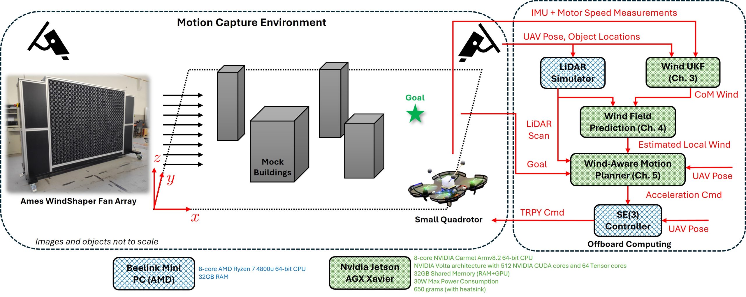

The ultimate goal with all these experiments was to test out my methods for wind prediction & estimation and wind/obstacle-aware motion planning in real time. We tested these algorithms through multiple trials across five “building” configurations, totaling over an hour of actual flight time. Below is a video showcasing the wind field prediction happening in real time.
In this trial, the Crazyflie is trying to track the XY location of the end of the wand while also avoiding the obstacles using (simulated) LiDAR scans. Meanwhile the WindShaper is throwing wind at about 4 m/s at the drone. This particular trial was focused more on the wind prediction side of things rather than motion planning, so the motions aren’t particularly exciting. Nevertheless, the network was capturing salient flow features like the high speed wind tunnel effect between the building clusters.
