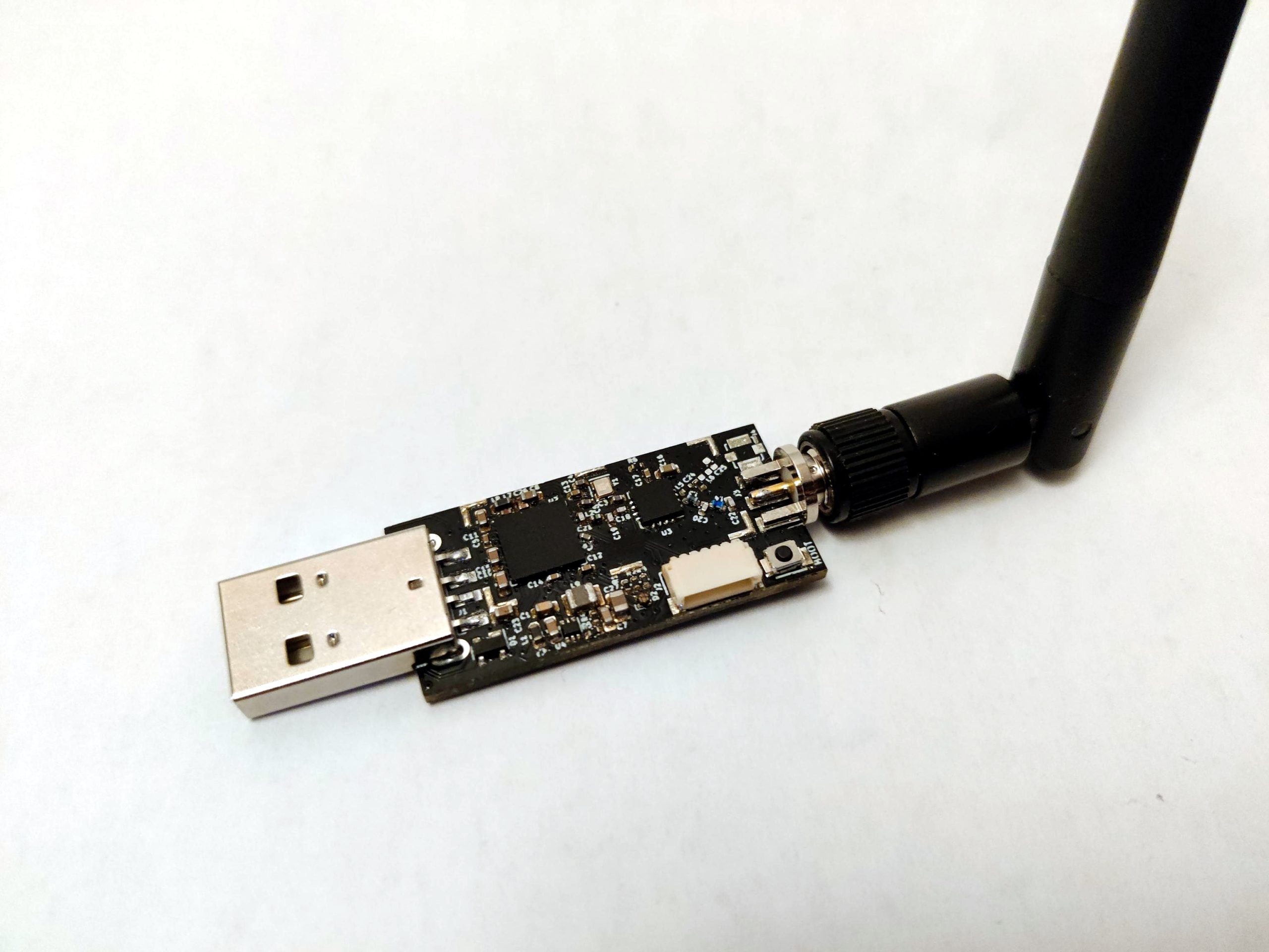

Crazyradio PA: a small USB dongle that did a lot of work
The second product leaving the store is the Crazyradio PA. It has been our main USB radio dongle for communicating with Crazyflies for many years. Based on the nRF24LU1+, with a power amplifier providing up to 20 dBm output power, it provided the communication link behind everything from someone flying their first Crazyflie to fairly substantial research swarms.

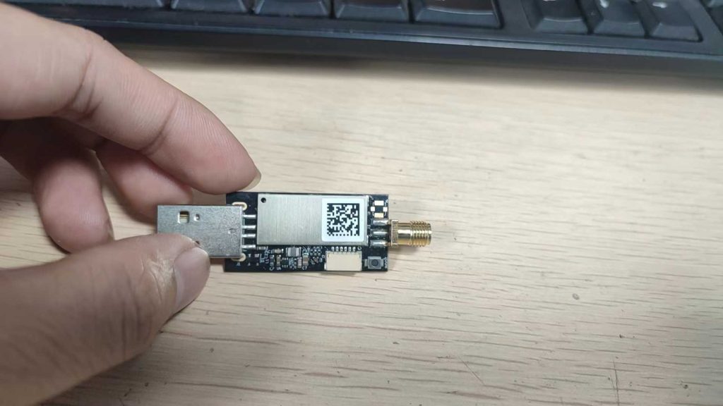

By 2023, though, the nRF24LU1+ platform was becoming increasingly limiting for what we wanted to do next. That led to Crazyradio 2.0, based on the much more capable nRF52840. From the beginning, Crazyradio 2.0 was designed both as a replacement for Crazyradio PA and as a platform on which we could continue developing the communication side of the Crazyflie ecosystem. The nRF52840 gives us substantially more processing power, memory and radio flexibility, as well as a more convenient bootloader and room to experiment with new communication protocols and scheduling strategies.
Earlier this year, for example, we flew 49 Crazyflie 2.1 Brushless drones using a single Crazyradio 2.0 while testing cflib2 and improvements to the radio firmware. That is a useful illustration of why moving the radio platform forward matters: communication is part of the research infrastructure too, especially when experiments start scaling from one robot to many.

And as far as a radio goes, the Crazyradio 2.0 is the only alternative on which ongoing communication development is focused.
