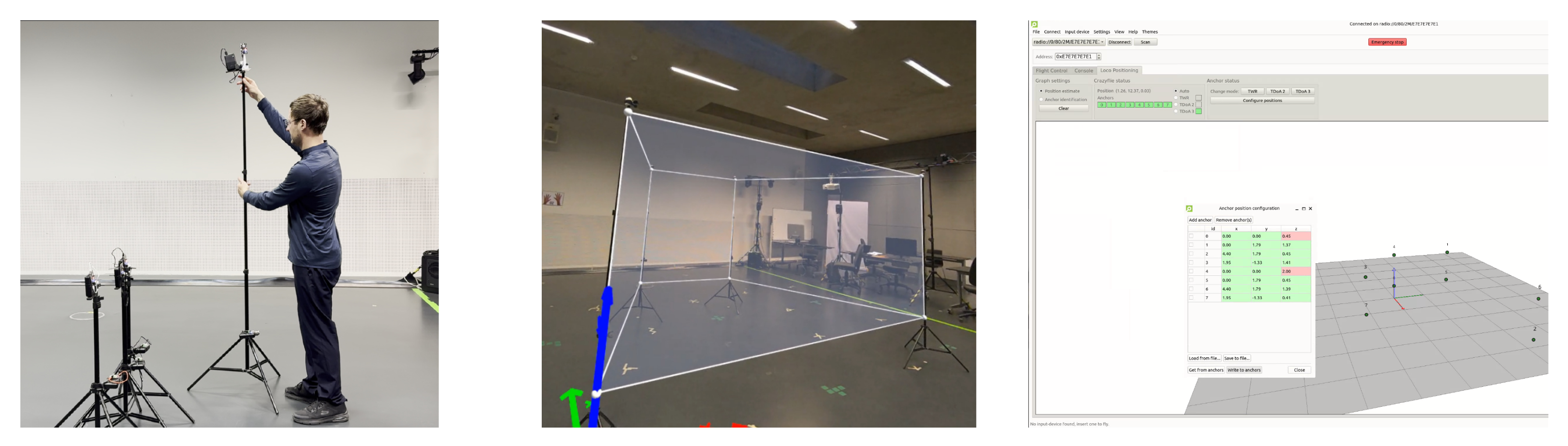

Setting up a mobile indoor positioning system with the Crazyflie platform—specifically using the Loco Positioning System (LPS)—typically involves walking through a large room with a laser measure, sticky notes, and a bit of patience.
That was exactly my situation at work when setting up UWB anchors for mobile robot demonstrations, which often had to be relocated to different rooms.
And it got me thinking—what if there were a more intuitive, flexible way to define and deploy these setups, especially in labs or educational settings where reconfigurability is key?
This question led to the development of XR-PALS, a mixed reality tool that simplifies the entire LPS configuration process.
Instead of manually measuring anchor positions and inputting coordinates into cfclient, XR-PALS allows users to create and sync virtual and physical setups almost seamlessly—just by moving virtual anchors in space using a VR headset.
Diagram showing the three-step setup for the Bitcraze Loco Positioning System: 1) Connect anchors, 2) Configure the system, 3) Track the Crazyflie drone in 3D space.
Three-step setup process for the Bitcraze Loco Positioning System, illustrating anchor connection, system configuration, and 3D Crazyflie drone tracking.

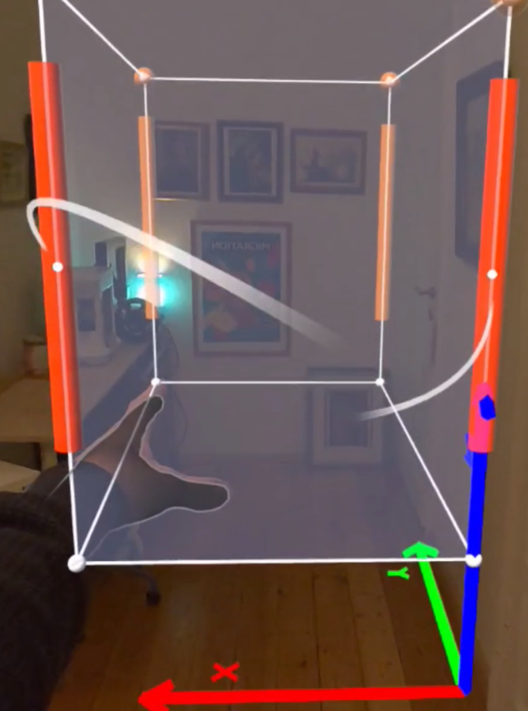

It runs on a passthrough VR headset (we used Meta Quest 3), allowing users to visualize the LPS layout and manipulate anchor placements in a virtual 3D environment until they are virtually and physically aligned.
Once everything is aligned, a single tap on the “Export” button sends the virtual anchor positions to a Rust-based middleware service running on a host machine within the same network as the VR headset.
It’s fast, visual, and eliminates the need for hand-measuring coordinates for our mobile robot demonstrators.

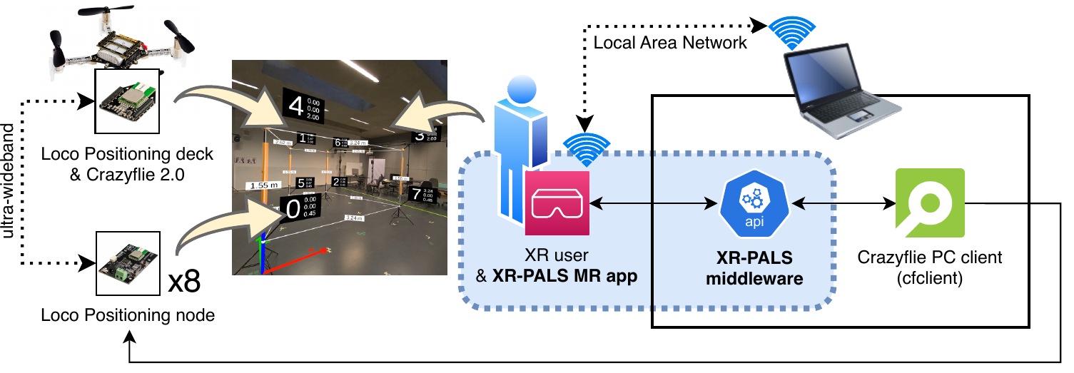

XR-PALS consists of two main components:

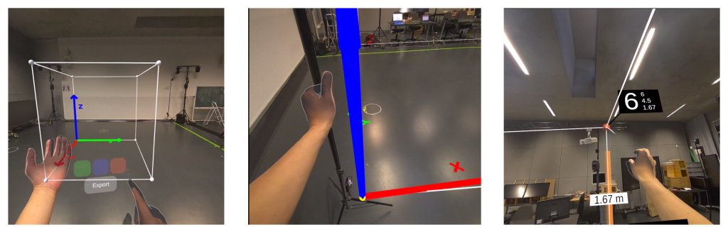

  1. VR application
    Runs on a VR headset and displays the full anchor layout. Users can drag anchors, view distances, toggle info layers, and adjust alignment using natural hand gestures.
  2. Middleware service
    A Rust-based REST API that basically bridges the VR app with the LPS anchors. This service receives the coordinates and remotely updates the LPS anchors—enabled by the open-source nature of the LPS firmware: bitcraze/lps-node-firmware. Coordinates are exported as YAML that can be imported by cfclient.
Diagram showing the system architecture for the XR PALS setup, including UWB anchors, Crazyflie drone, tracking system, and XR interface components connected through data and control flows.
System architecture.

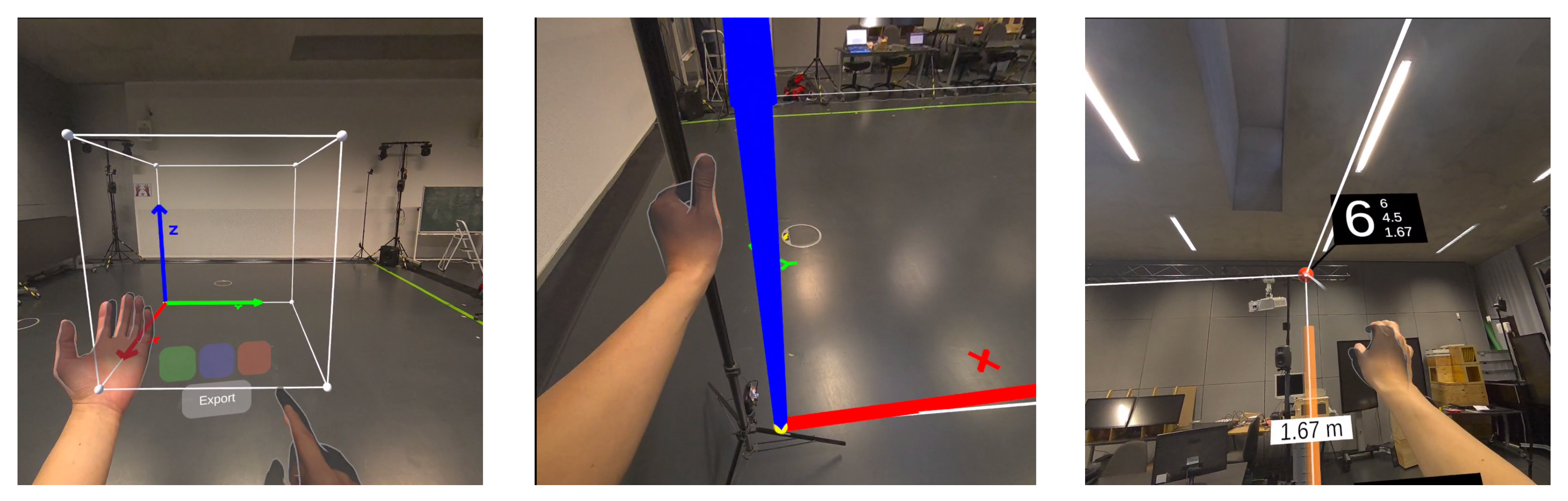

Images of XR PALS user interactions, showing a person wearing an XR headset controlling a Crazyflie drone in a physical space with visual overlays and positional feedback.
User interactions.

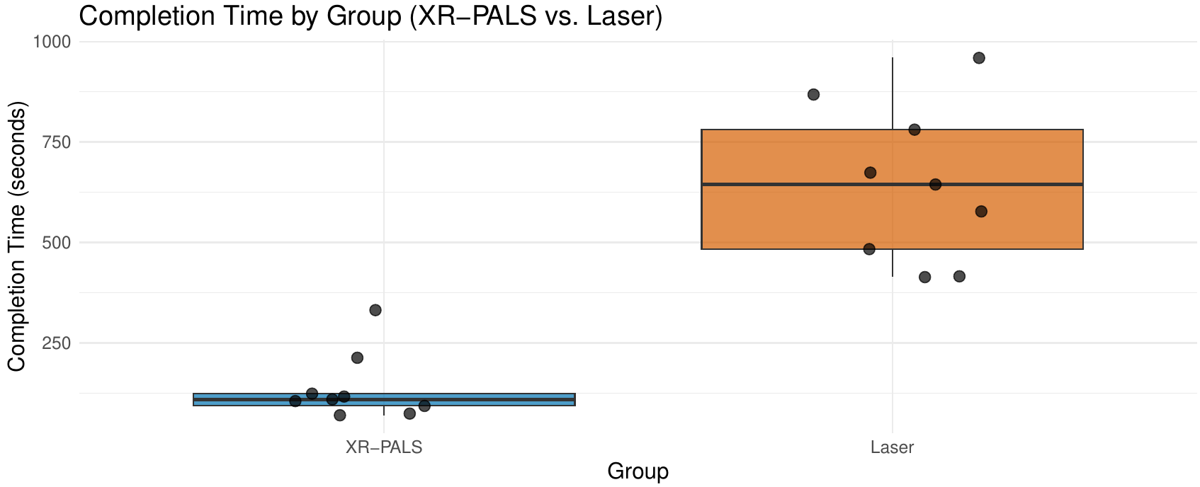

Bar chart comparing average task completion times for XR-PALS and laser methods, showing XR-PALS with shorter times. Lower values indicate better performance.
Bar chart comparing task completion times between XR-PALS and laser. Lower values are better.

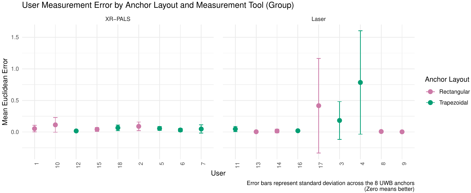

Bar chart comparing average measurement errors for XR-PALS and laser methods, showing XR-PALS with lower errors. Lower values indicate better accuracy.
Measurement error comparison between XR-PALS and Laser. Lower values are better.
The minimal loss in accuracy compared to the time saved is not dramatic for our use cases, compared to the time saved—especially when more participants were able to correctly determine the coordinates overall.
In general, users were more confident using VR glasses than a laser measurement device.
