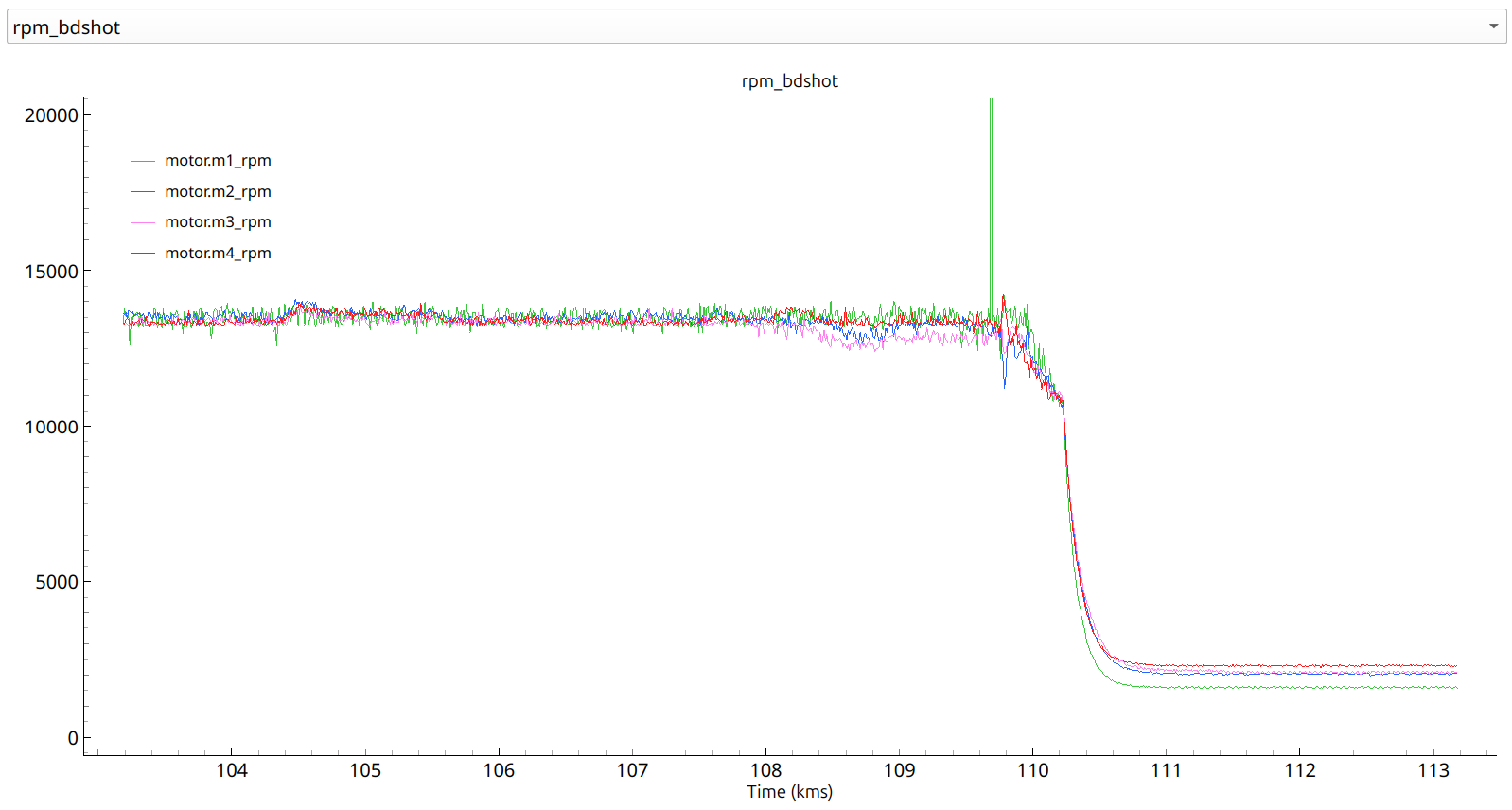

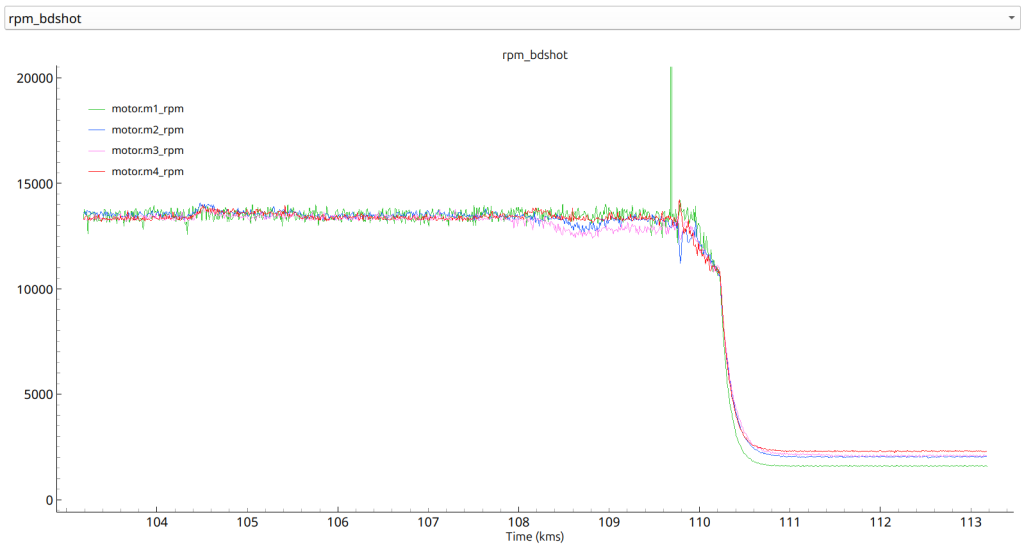

Plot showing RPM measurements during hover and landing

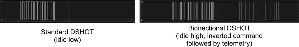

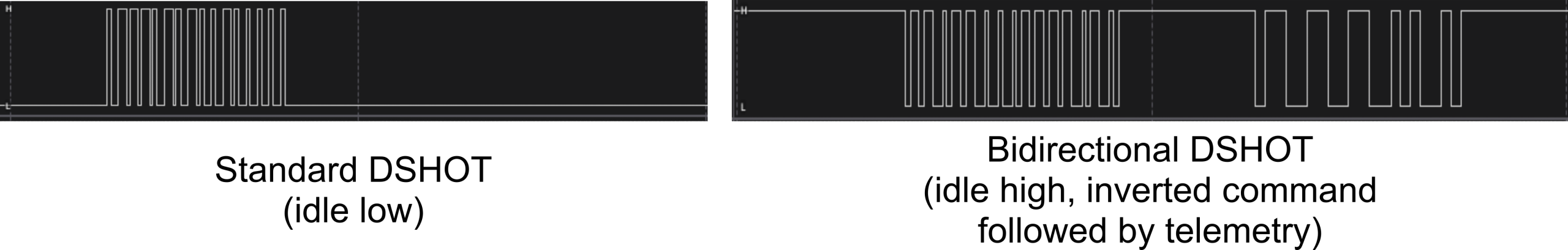

Logic analyser captures of the standard and bidirectional DSHOT exchanges. In bidirectional DSHOT the command frame is followed by the GCR-encoded telemetry response.

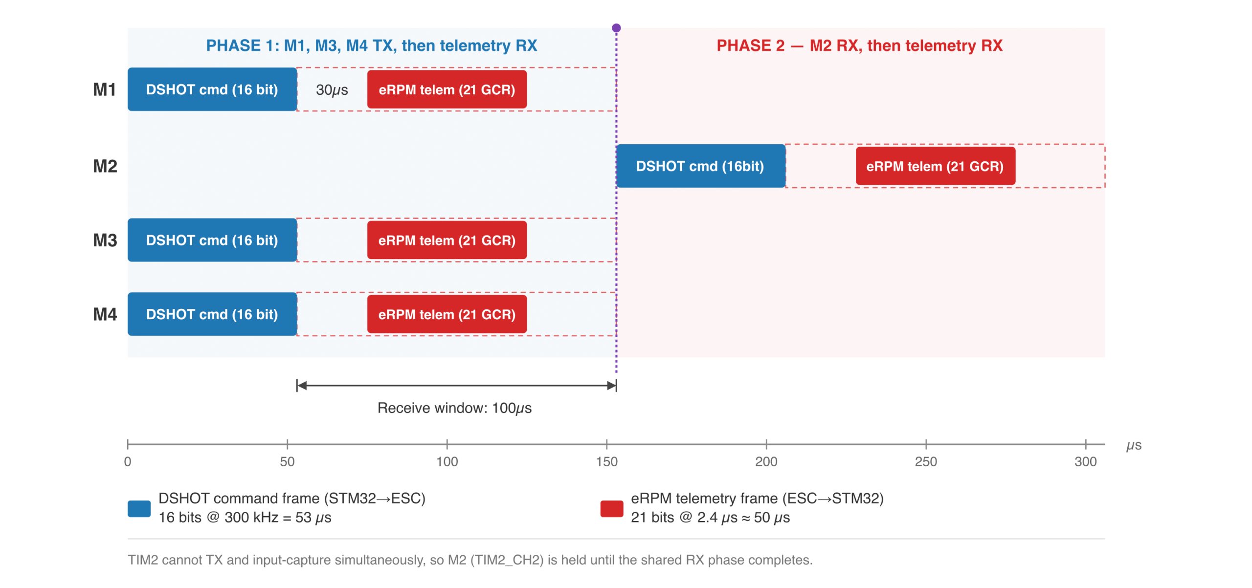

All four motor DSHOT outputs share the TIM2 timer on the STM32. This was not an issue with traditional DSHOT: the timer is left free-running, and each motor can be controlled independently. With bidirectional DSHOT, the transmit and receive phases require different timer periods (the command and telemetry frames have different bit rates), so the transmit and receive phases can’t overlap between motors.
The solution is a two-phase scheme within each control cycle:
  1. Phase 1: Transmit command frames to motors M1, M3, and M4. After transmission, switch the lines to input and capture their telemetry replies.
  2. Phase 2: Once the receive window closes (detected by a TIM2 interrupt), transmit the command to M2 and capture its reply.
This sequencing means M2’s command is delayed by roughly 100 µs relative to the other motors — the cost of sharing a single timer. In practice, at the Crazyflie’s control rate, this additional latency is negligible.

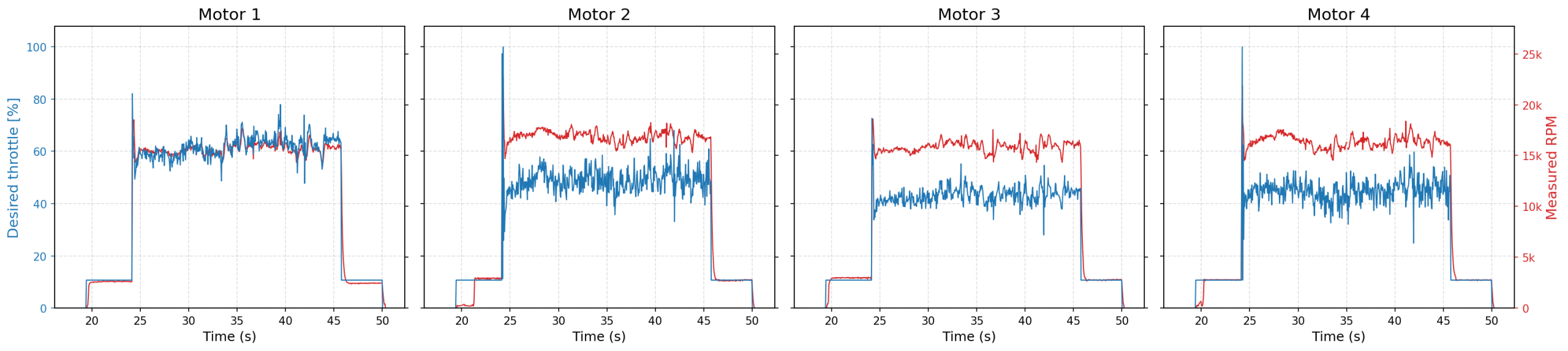

Desired throttle vs. measured RPMs over a 30s flight.
To verify that the telemetry readings are correct, we compared the reported RPM values against the thrust-stand characterisation performed for the battery compensation work. At a given commanded thrust and battery voltage, the expected RPM can be computed from the motor voltage–thrust polynomial and the motor’s known Kv constant. The onboard RPM readings match this prediction well across the operating range.
During flight, the RPM traces clearly show the motor dynamics that the open-loop command model doesn’t capture: spin-up and spin-down transients, asymmetries between motors, and the RPM dips that correspond to aggressive attitude changes. This is exactly the kind of information that was previously invisible to the firmware.
