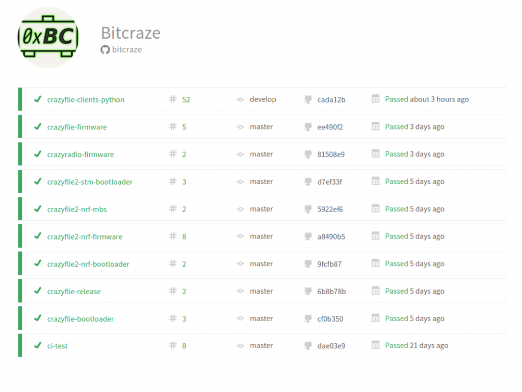

We have decided to use Travis for continuous integration builds of our open source repositories. Travis is automatically building the code on all branches and pull requests, which gives all developers that wants to contribute to the project, the possibility to see that their code passes the build. The current status of the latest build on the main branch, is visible through the icon in the readme in github, or on the Bitcraze page at travis.
