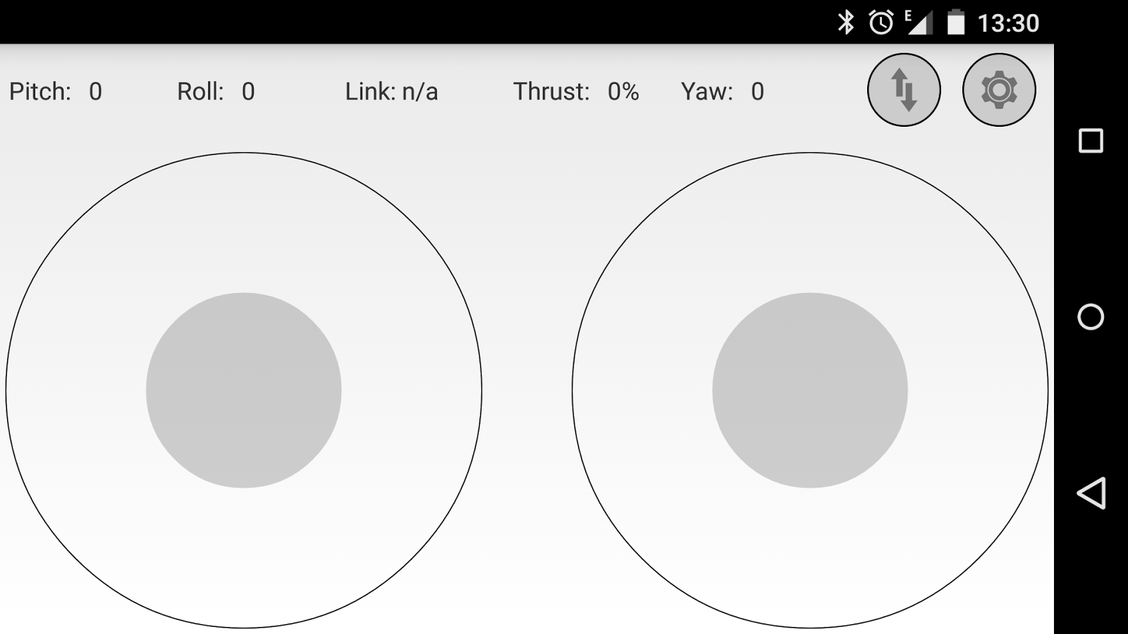

New Android release
The Android client is also going forward thanks to Fred. This evening we are releasing an update that enhance the GUI and allow the app to run full screen on Android 4.4+. The update is going to be released on the play store.
