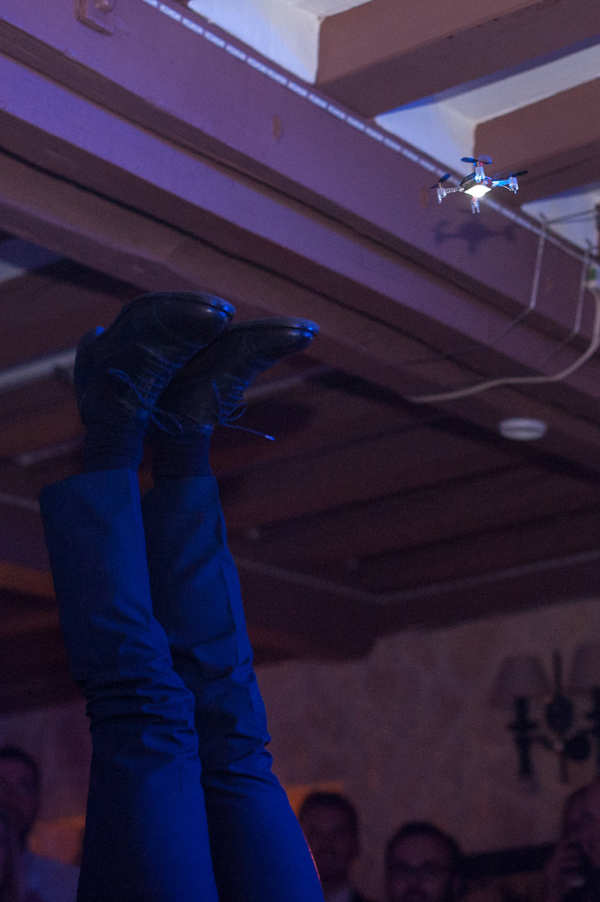

We are engineers and not choreographers but after some trial and error we managed to create a sequence with light that was synchronized to the music. The overall idea was to start the Crazyflie on the floor in the center of the space, go out into the audience during the intro and turn on the light over Adrian (that was carefully positioned on the correct spot) and guide him onto the “stage”. While Adrien improvised acrobatics on the floor the Crazyflie circled around and above him with flashing lights. At the end of the music the procedure was reversed and the Crazyflie guided him back into the crowd and landed quietly in the center of the stage.

After dinner when it was time for the show we set up the positioning system and the crowd gathered. The first two attempts failed as it turned out that the ceiling of the venue was lower than expected and the Crazyflie hit a beam! What to do? We had a pre-programmed sequence that was going too high! We simply moved the anchors 30 cm away from each other and “stretched” the space to trick the Positioning system a bit. We had not tried this before and live hacking is a bit stressful, but we were possibly strengthened by one or two glasses of wine :-)
The third attempt was almost perfect with an incredible performance by Adrien! Phhuuu and what a success on the third attempt. Heart failure was close but did not kill us this time! :-) Maybe this is why we stay away from live shows and rather sitt down in a dark basement coding :-).
