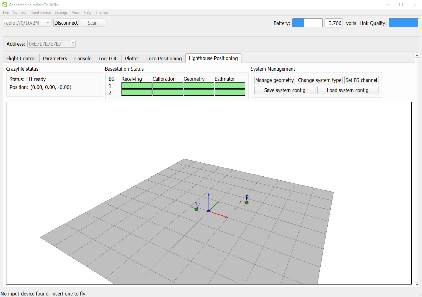

The main feature in this release is the stabilization of the Lighthouse positioning system. The main work done has been on the system setup and management, it has taken a lot of work spawning all the projects and a brunch of documentation, but we think we have reached a stage where the lighthouse positioning system is working very well and is very easy to setup and get working. We have now published the new Lighthouse getting started guide and will be working this week at updating all required materials to mark Lighthouse as released!
When the Lighthouse positioning system was released in early access, it required to install SteamVR, run some custom scripts and flash a modified firmware to get up and running. This has been improved slightly over time with scripts that allows to setup the system without using SteamVR and some way to store the required system data in the Crazyflie configuration memory rather than hard-coded in the firmware. With this release, everything is coming together and it is now possible to go from zero to an autonomous Crazyflie flying in a lighthouse system in minutes by just using the Crazyflie client.

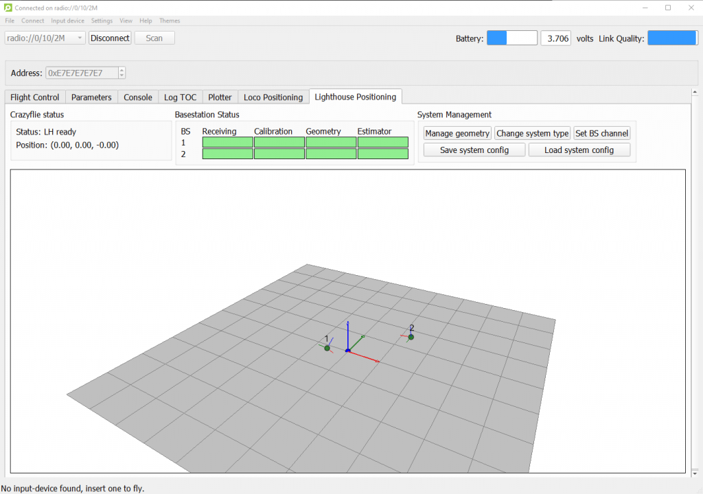

  • Thank you both for your instruction in getting my cfclient working again. I flashed my Crazyflie 2.1 with the latest firmware (2021.03). I am using two HTC base station V1 for my lighthouse position system. With updated cfclient and the lighthouse Tab, I changed the system type to lighthouse V1. However, the lighthouse deck is “not receiving” and the 3D visual display of Crazyflie position kept drifting. Is it because the default firmware build for Lighthouse V2 and I can’t easily switch to Lighthouse V1, or something else? Do you have instructions to build my firmware just for Lighthouse V1?
