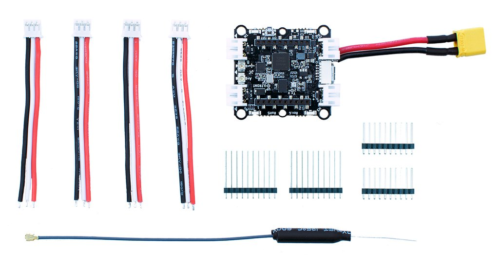

The Crazyflie Bolt kit
The Bolt will need different values for the tuning parameters for controllers and being forced to set these on each boot would be pretty annoying. And since we want the Crazyflie Bolt and the Crazyflie 2.1 to share the same firmware, persistent parameters would come in handy.
