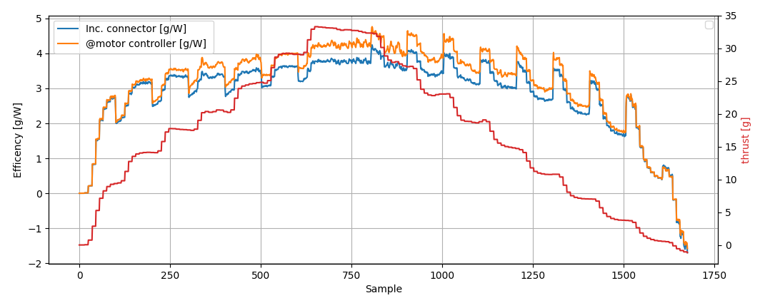

Using the thrust stand we wrote about and built earlier we can get an estimated value of the efficiency which is interesting in many aspects.
![](https://www.bitcraze.io/wp-content/uploads/2022/10/eff1-1024x413.png)
Instead of ramping up/down the PWM in very small steps as was done in the thrust stand post, the same test has been changed to do it in larger steps to make it easier to separate the changed efficiency effect when doing acceleration/deceleration. Another thing to note is that in this test the PWM was only ramped up to 50% as the RPM measurement sensor had trouble tracking the transparent-grey propeller at higher speeds. There are two lines graphing the efficiency where the blue line is the one including the losses in the connector which should be closest to the real overall efficiency. Following the blue line we can see that at ~33 grams of thrust we get ~3.8 g/W. Very similar to the stock Crazyflie 2.1 setup with 45mm propeller and 7×16 mm motor.
